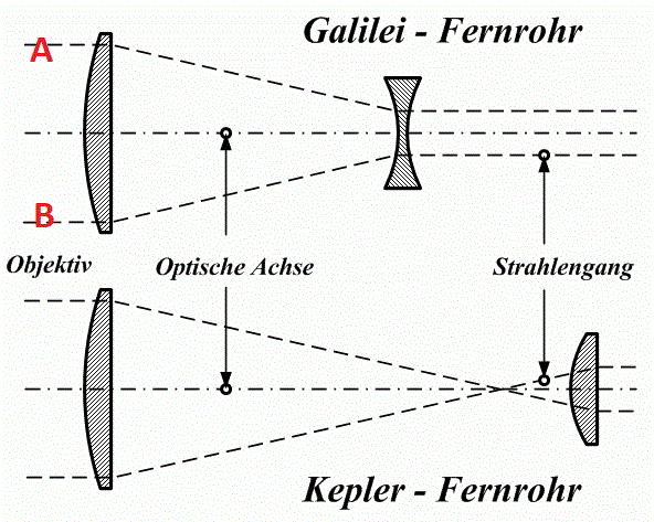

jbriggs444 said:
If it is a narrow ray, the pilot cannot measure its duration without a second observer and a simultaneity convention.
The pilot can measure it's duration without a second observer, i.e. if his Galilei-telescope has a diameter of ##23 km##. The time-dilation factor depends on the simultaneity convention.
Source:
https://de.wikipedia.org/wiki/Fernrohrbrille#Optischer_Hintergrund
Sagittarius A-Star said:
The pilot can measure its duration without a second observer and with a simultaneity convention, i.e. if his Galilei-telescope has a diameter of ##23 km##.
Source:
So you are going for the "broad beam" interpretation. You also seem to assume that the signal front arrives at ##A## and ##B## simultaneously. In what frame is that assumption justifiable? Do you see that it must be false in every other frame?
No, I assume a narrow ray. The first signal reaches the lens at location A, the second later at location B.
So you have a moving lens that sweeps across the narrow beam?
Yes.
Yes.
Or, equivalently, two mirrors arranged carefully so that the leading mirror catches the leading edge of the signal and reflects that leading edge to the pilot awhile the trailing mirror catches the trailing edge of the signal and reflects that trailing edge to the pilot.
Refraction or reflection, the result is the same. The physical situation will allow the realization of a simultaneity convention, as you had pointed out.
Yes, that could work.
Of course, there will be some disagreement about the geometry of the situation due to aberration.
