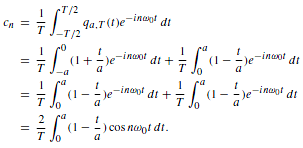

I have an example were they determine the Cn coefficient for a Fourier series:
My problem is i don't follow what happens in the following moment:
neither am i sure how the two e^-inwt comes to be cos(nwt) in the last part.
The only solution I can come up with is to reverse the limits what is obvious and then say: t=-a --> -1*t=-1*-a and then change a for -a in the limit and t for -t. However this doesn't work in other similar problems so I don't think think this is right.

there's a misprint :redface:
the first exponent in the third line should be positive
between the second and third lines, they've substituted u = -t, du = -dt, and then renamed u as t again!
and of course the corrected third line let's you use eix + e-ix = (cosx)/2 :wink:
A misprint... Yeah that clears up a lot :D
Thank you very much!
