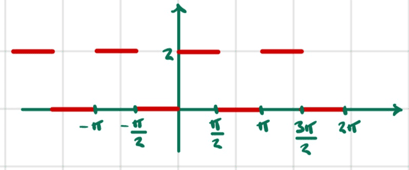

I've been learning about Fourier series and I have a few questions.
Consider the function
$$f(t)=\begin{cases} 2\ \ \ \ \ 0<t<\pi/2 \\ 0\ \ \ \ \ \frac{\pi}{2}<t<\pi\end{cases}$$
Here is a plot
We see that this function has minimal period of ##\pi##.
Initially, the material was presented with functions that had a period of ##2\pi## and were explicitly defined on the interval ##[-\pi,\pi]## and defined everywhere else by ##f(x+n2\pi)=f(x)##.
Then it was shown that actually, if the period is ##2L## we can rescale ##[-\pi,\pi]## to ##[-L,L]## and we get essentially the same formulas for the Fourier coefficients.
I want to make sure of the following
The function ##f## was defined above in terms of an interval ##[0,\pi]##.
We could obtain formulas for the coefficients in terms of integrals of this interval. The only difference is that the formulas would be substantially more complicated since we would no longer be making use of the same simple orthogonality conditions of the ##\sin## and ##\cos## functions used to derive the coefficients when we are using an interval symmetric about the origin?

This means that considering ##f## in the example given at the start of this post, if we shift it in time such that it is no longer symmetric about the ##y##-axis this does not change the fact that we can compute the Fourier coefficients.
##g(t)=f(t+\frac{\pi}{4})## is not symmetric about the ##y##-axis. The formulas for the coefficients of the Fourier series of ##g## would be more complicated. However, for such functions (which are the result of shifting and scaling of functions that are symmetric about the ##y##-axis) we use mathematical tricks to find the coefficients rather than computing them directly. In the case of ##g##, we simply take the Fourier series of ##f## and substitute ##t+\pi/4## for ##t##.
1. The appropriate expansion functions are orthogonal. There is nothing really strange going on, just use ##L = \pi/2##.
2. I cannot see a question here. Just statements.
3. Your original function is not symmetric anout the y-axis. Shifting by ##\pi/4## gives a function that is.
It would all depend on f what is the easiest way of computing the coefficients.

Indeed you are correct.
I wrote a lot of incorrect statements in that third question.
The original function is not symmetric about the ##y##-axis that is true.
Any interval on the ##x##-axis with the length of one period symmetric about the ##y##-axis allows us to compute the Fourier coefficients.
I think what I was and am trying to get at is: can we use an interval that is not symmetric about the ##y##-axis to compute the Fourier coefficients?
zenterix said:
I think what I was and am trying to get at is: can we use an interval that is not symmetric about the y-axis to compute the Fourier coefficients?
Of course you can. The periodicity ensures that the integral over any full period is the same.
