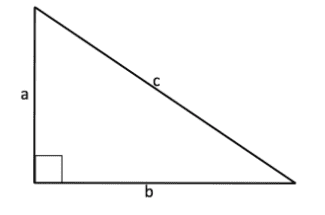

Project is to design and build a CO₂-powered metric car that is fast, lightweight, aerodynamic, and tracks straight, out of a right-angled wooden block (measurements are currently escaping my mind right now). The block of wood I am supposed to be using is a right triangle. (the lengths are a, b, and c, just for reference. a is the shorter side and b is the longer side. b is intended to be the bottom of the car. c slants downwards from a to b.)
I guess this is kind of an accurate depiction of the side view, but the real thing is just shorter.
My instructor specifically stated b should not be changed too drastically as that's where we'll drill a hole 5 cm long for the CO₂ cartridge. obviously I can sand down above and below the hole but not too much.

So I'm a bit confused. Can you say more about how your design will be evaluated? When you say "fastest car", how were they tested? Is it like a scale-model standing 1/4 mile drag race where terminal velocity determines the winning car? What are typical winning speeds in this contest?

One way my teacher has mentioned to measure my final model is through wind tunnel testing. It's unfortunate, but my teacher specifically stated "Some will go fast, others will go slow." There really is no other way to put it. It's just whoever gets to the Once the due date arrives, I'm inclined to believe there will be a track set-up outside the classroom (supposedly around 10-15m based on the particular day, based on previous classes). I'm sure there will be some kind of evaluation to ensure our models follow the guidelines. Unfortunately, no information was posted about how long it took for some of the winning models to finish the track.

It seem strange that your instructor is not making clear evaluation rules/guidelines/procedures available for this project. It is hard to do design optimizations without clear goals set forth. @gmax137 and I are both asking what sort of speeds are involved because it makes a difference in how to optimize your design. For example, at most practical speeds on a 10m track, air resistance will be extremely small, so making the lightest car will give the best acceleration and highest speed...

Whelp, I would probably go for making the model as light as possible and not worry about the aero, given what you have said so far. So I would spend my time drilling holes all over the model to remove as much material as possible and still let it be structurally okay to bear its own weight. But that's just my take...

I would concentrate on ensuring the car runs straight. And minimize friction in the wheel bearings / axles. Look into pinewood derby winners.
Welcome, Sophia!
Engineers do not re-invent things that have been developed for a while.
They learn about what others have done, and try to improve it.
Just look up CO2 dragsters.
