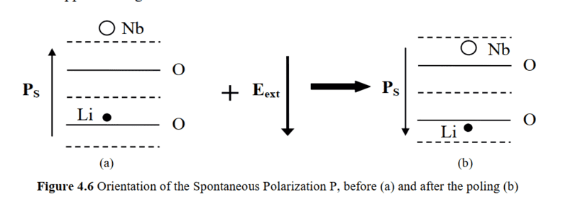

Hi community, I am trying to find an expression of coercive field in lithium niobate crystals on the context of interaction energy, we know that the coercive field in ferroelectrics is the reverse electric field necessary to bring the polarization to zero, in other words and in the case of Lithium niobate which the orientation of the spontaneous polarization Ps is determined by the position of Li+ and Nb5+ ions along the z-axis with respect to the oxygen layers, the coercive field, Ec represents the minimum electric field required to displace Li+ and Nb5+ ions from the configuration of fig. 4.6a, to that of fig. 4.6b.
Diagram of spontaneous polarization Ps in lithium niobate: (a) Li and Nb ions placed above and below oxygen layers with Ps pointing up, an external field Eext pointing down, and an arrow to (b) with Ps pointing down and the ions swapped in position relative to the oxygen layers.

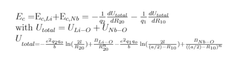

If we considered that the Nb ion with charge q1 is displaced from its centrosymmetric position by (a/2) - R10 while the Li ion with charge q2 is displaced from its centrosymmetric position by a distance R20 and taking in account that the interaction energy between crystal planes in LiNbO3 is given by the following equation ( a is the distance between two oxygen planes and b is the lattice constant )
Equation for interaction energy U_ij = (-e^2 q_i q_j / b) ln(2l / R_ij) + B_ij / R_ij^n.

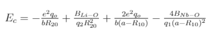

Is the following expression of Ec that I obtained logical and acceptable ? (n=1)
Equation for coercive energy Ec: minus e squared q_o over bR_20, plus B_Li-O over q_2 R_20 squared, plus 2e squared q_o over b(a minus R_10), minus 4B_Nb-O over q_1 (a minus R_10) squared.
such that I followed the following steps to get the result
Equations for coercive field Ec = Ec,Li + Ec,Nb, Utotal = ULi-O + UNb-O, and the expanded Utotal expression with logarithmic and power terms in R20, R10, a, b, and n.
  • Equation for coercive energy Ec as a sum of four terms: minus e squared q_o over bR_20, plus B_Li-O over q_2 R_20 squared, plus 2e squared q_o over b(a minus R_10), minus 4B_Nb-O over q_1(a minus R_10) squared.
