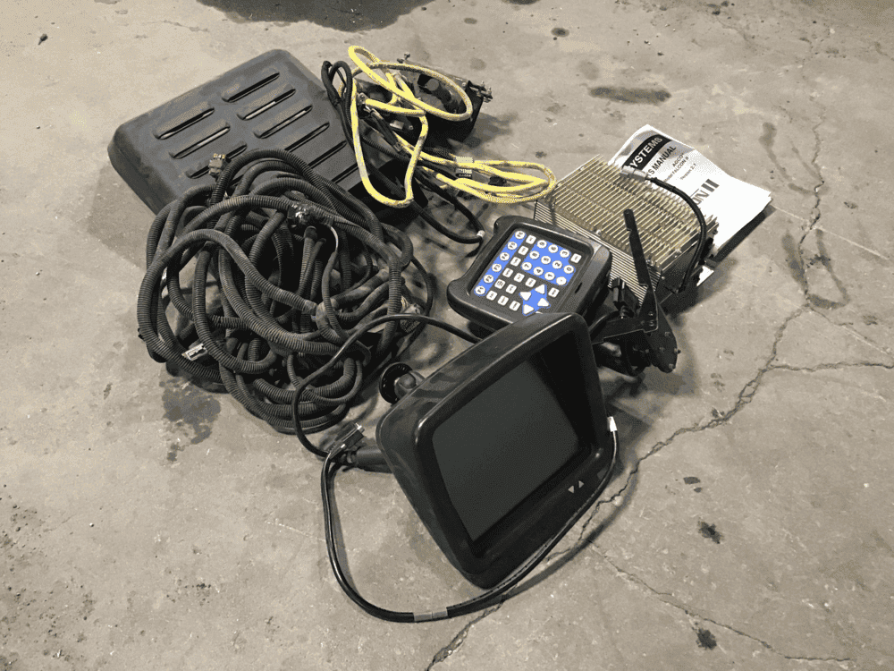

Lol. These machines can likely go for ten months without being powered up. A twenty year old lithium coin battery is expected to soon be at the end of its life. No doubt. But the service tech claims a fresh one gets drained overnight. What I really suspect happened is they put in a new battery the first time I shipped it off when they likely found a dead one. I would not have been surprised either to find a dead one that is around twenty years old. The rest of the unit was checked out, powered down and returned to me. The unit probably had already drained the battery by the time I received it back. I just didn't check it out immediately after I received it. Bigger things to worry about at the time.
I did manage to find a factory reman of this unit from the OEM. The price tag is $6500 with exchange. Dealer price. Not an e-bay seller. Without the exchange the price goes to $8500. I won't be going this route.
The latest:
The unit arrived back to me yesterday. I put it on the bench tonight and here is what I found: The lithium battery is in fact dead. I removed it and hooked a three volt supply in place of it with a 100K resistor in series. The voltage drop across the 100K is 95 mV. The thing is drawing less than a uA. I question whether there was an attempt to even repair it. I have to say it was not the most fun thing to disassemble. For whatever reason the tech decided it would be a good idea to blob the little battery with black RTV silicone. Worried about vibration or wanted to make sure the next guy to deal with it would have fun? Here are some pix.

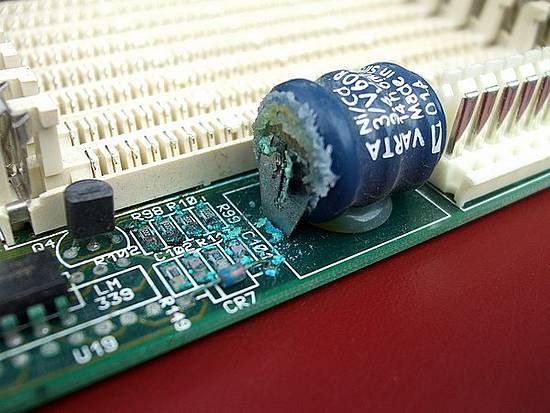

Once I've found one of https://www.ebay.com/itm/Alaris-Leopard-LX-386-Motherboard-Rev-D-486SLC2-Vintage-IBM-PQ-14/353290613318. With battery a bit worse shape than on that picture above. I could cry... Removed all the RAM slots and many SMD components, repaired many tracks... Took dozens of hours... Ended as a donor :cry:
Ps.: by the way, check those pictures about the battery there o0)
