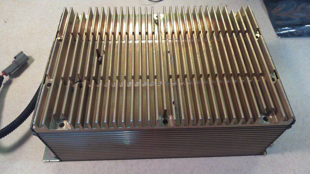

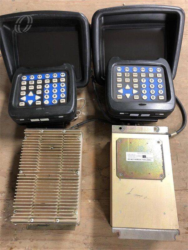

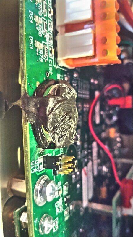

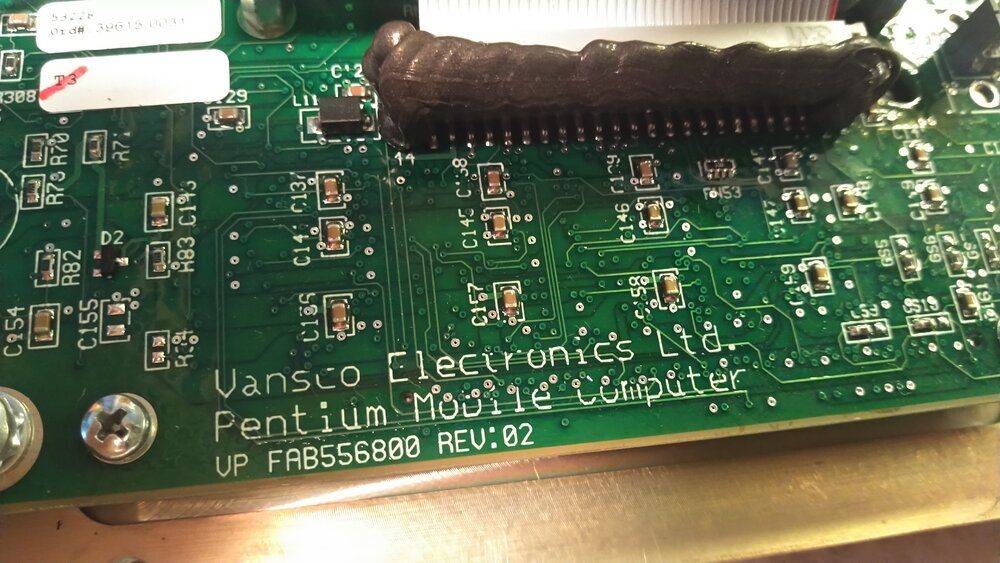

I've never replaced the internal battery because I've never used this hardware. I've only had the machine a short time. I sent the computer, it's mobile display and a mobile keyboard off to a place that repairs these. This was last year. The display was damaged and they repaired it as well as what the keyboard uses as a mouse. It was shipped back to me and I powered it up last week. Everything is completely new to me. The rest you've all been told. So, with over $1K in repairs already and the motherboard supposedly unrepairable, I'm a bit ticked off. I honestly suspect that the first time I sent it off to be gone through, only parts of it were evaluated. I'll try to post some pix for those interested.

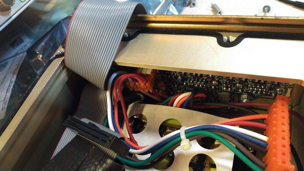

Here it is. Sorry I don't have pix of the internals of the case. I'll have to wait until I get it back. Being new to delving into a computer motherboard, wondering just how many places the power from the battery goes. I've always assumed pretty much just one device. And maybe a capacitor. Someone can correct me if I'm wrong. There's a bit more to the keyboard than it looks. On the back side there is a 3.5 floppy drive as well as a USB port. Plus what they use as a mouse. A little flaky to use the mouse but the short time I've played with it I think I could get used to using it. The outboard units that this computer talks to are not pictured.
Edit: BTW, the battery is soldered to the board. This is why I sent it back. They advised I not do it myself even though I used to do rework for a living. Plus, I had something else to ship to them in the same box and I wanted them to know that they dropped the ball so-to-speak.

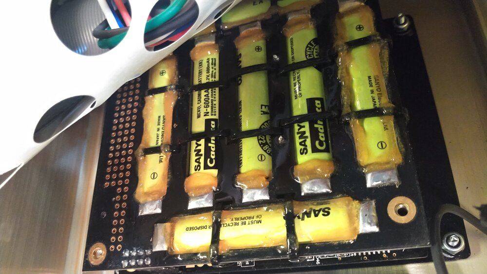

You are correct. There is a CMOS battery that motherboards typically have and the vehicle battery. Large truck chassis so actually 3 large truck batteries. I have reservations about attempting to power the CMOS as I suspect a leaky diode. This could potentially try to power up the 5 volt power rail. I think I'll try to track down where the leak is.

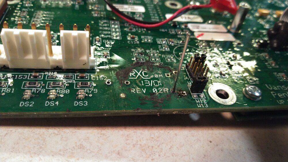

Here are a few possibilities I've run across with extremely short coin cell life; the first and third ones are the most likely, otherwise no particular order.
1) If the soldered-in battery has been replaced, the board around the soldering MUST be well cleaned. Leaving even a little bit of flux on the board will drain a coin cell in a couple weeks. The solder flux is slightly hygroscopic and absorbs moisture from the air. This creates a leakage path to drain the coin cell.
2) After many years in a mixed industrial & city environment, there was enough pollution deposited on the motherboard to act as the above situation. Actually it was a bit worse; there would be occassional program crashes. These cleared up after removing and washing the motherboard, not for the faint-of-heart or in-experienced.
3) Your conjecture about a bad electrolytic is a very real possibility. The one (typical?) circuit I can find at the moment has the clock kept alive during power-off by the battery but powered from the DC supply when operating.
The switching is accomplished with a "diode or" circuit, that is there are two diodes in series with the battery and another diode from the DC supply, both feeding the clock chip. There is often (always?) an electrolytic connected to the clock chip Power pin. The one example I can find at the moment has a 22uF, 16V cap. That should be relatively easy to locate once you get access to the motherboard, especially if you can identify the clock by the chip Part No. Or just trace the circuit from the coin battery "+".
4) The replacement battery was not 'fresh' when installed. For instance some of the Big Box department stores seem to buy in huge quantities and then store the product in non-climate-controlled warehouses. This is a problem here in the South West of the USA, the warehouses are in Desert areas where the land is cheap. This affects just about any non-food with an expiration date, batteries, over the counter drugstore products, cosmetics, small tubes of paint, etc.

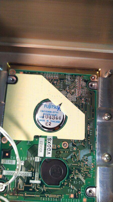

Did you see it, or this is what 'they' told you? It gives some chance that the battery is not the standard coin cell.
Do you have a type for the unit? Or some pictures?

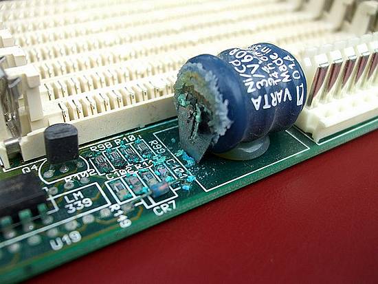

If the CMOS battery is some old style 3.6V NiMh or NiCd thing (for the Win98 era it's rare, but still happens) that may be a bit worrisome
This kind of thing requires quite some work to clean up (and it'll never be like the new ever again :frown: )
It is in fact soldered to the board. I have seen it. It is a lithium type thing with leads. Not the leaky thing in the above pic.

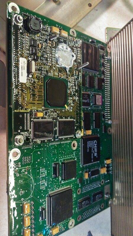

@Vanadium 50 read the whole thread already. If you had you would know it has been sent in for service the second time now for the reason of having a dead CMOS battery after having set unused for about a year after (supposedly) being checked out thoroughly. Do you really think I just have a 'theory' of a CMOS battery going dead overnight? After all I've posted here, you assume there hasn't been any communication with the company that services these machines? Btw, it's not $2K over twenty years. It's more like$12K to15K original system cost. It's getting very difficult to find replacements for anything involved.
In all likelihood what will happen is I will either find the leak myself since the company that I sent it to won't go any farther with it or the whole system will be replaced. I'm not dumping any more money into this system. I was Leary about dropping $1K into it last year, but did because I was told it's ready to go. I can likely recoup some losses by selling the remaining pieces and I will simply start over.
