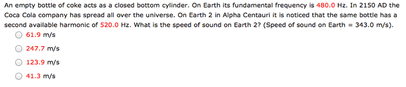

This is what I tried doing, but I ended up getting an answer that isn't listed above
1. frequency = speed/wavelength
2. On Earth
480 Hz = (343 m/s)/wavelength
wavelength = 343 / 480
wavelength = 0.714 is the wavelength for the Coke bottle
3. On Earth 2
Since they already gave me frequency on Earth 2, and I already solved for wavelength, all I have to do is plug in those numbers to solve for speed on Earth 2.
(520 Hz) = speed/0.714
(0.714)(520) = speed
371.58 m/s = speed
Wait...I think first i have to find the harmonics...
You're dealing with a fundamental frequency on Earth, but a harmonic on Earth 2. What harmonics can a closed-bottom cylinder produce?

Still here. You should confirm which harmonics can be produced by a closed-end pipe.
So, when the problem states that "a second available harmonic of 520Hz is available", which one do you think they're referring to?

Why 104? The frequencies will go: 520, 520/3, 520/5, 520/7,...
The second one is 520/3, right?

I have a problem with the length of column (bottle) that you're using (Think about a coke bottle over 70cm tall!). While the error has fortunately canceled out along the way, I can't in good conscience say that your answer is altogether correct :smile:
On the web page that you found, take a look at the table partway through that shows the column length \ wavelength relationship for the various harmonics. Note that the fundamental is NOT the same length as the column.

On Earth 1, the fundamental is 480Hz, speed 343m/s. Wavelength is then 0.715m. That's fine. But the bottle has length L = λ/4, so L = 0.179m. The length is assumed not to vary between planets (same bottle).
So take that bottle length and the harmonic 520Hz and use the appropriate length versus wavelength relationship to find the speed (since v/f = λ, and λ = (4/3)L for this harmonic).

Hmm. If L = 0.179m and f = 520 Hz for the harmonic n = 3 where n = 1, 3, 5, 7,... then
## v = \frac{4}{3}L f = 123.9 m/s ##

On Earth 2:
For the second available harmonic, harmonics being 1, 3, 5, 7,...
##v = f \frac{4}{3}L##
Where f = 520 Hz, L = 0.179 m.
