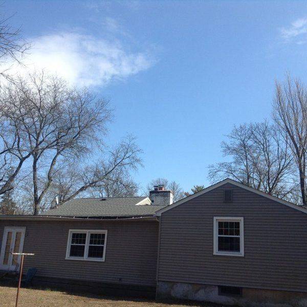

No, I have never been up on the roof. You think it's where AC unit is...but I always thought the unit is outside in front of the kitchen because it has big fan... Looks like horizontal propeller. What is that housing with fan outside doing in front of the kitchen if you think AC unit is on the roof? Can it be possible to have both? I will identify that housing tomorrow. It's already dark. And let you know.
That sounds like the AC unit. I don't think you mentioned it before, so I thought it might be on the roof. I doubt that there are two AC units.
Right, I never mentioned ac unit on the roof. I had said ventalitor.. Anyway the ac unit on the roof you suggested may be attached via ductwork to housing outside to exhaust hot air. I will take another look at the housing tomorrow morning. I think you solved it.
The surrounding air in the attic not inside ducts has to be ventalited, too but this is another thing. I thought it was already solved, I will let you know tomorrow.

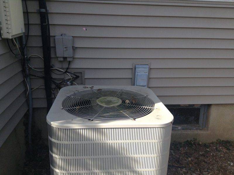

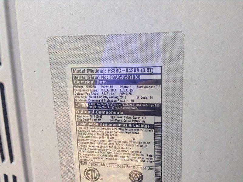

Two pics.. The first one is AC because no ducts are attached to it. When AC is turned on, I could feel hot air coming out from the top of the AC.
The second one is the label for AC.

After reviewing AC (refrigerator) basics, the AC has condenser coils inside throws out hot compressed air from coolant i.e. freon. on the condenser fins. It has to go compressor first before that happens. The coolant now gets little cooler after throw it out then go through expansion device to expand coolant further to make the coolant cold further at low temperature then through evaporator coils in the attic with cold coolant inside. The hot air linside the attic are absorbed to the evaporator coils make air in attic cooler. The absorbed hot air inside the coolant now warm. It then goes to compressor to get very hot on way to condenser coils. And the cycle repeats.
The basics help me get general understanding.
I am uploading a picture of the roof. It's not close up, but you may see like a small black hat on the top roof. The others on right belongs to chimney. not related to this topic. By now I think it (black hat) has nothing to do with AC. It's separate by itself.i believe there is a "evaporator" unit somewhere in the attic that couples with AC outside.
I will find out on April 4th. Thank you guys for the help.

Have you ever been up on your roof? I'm betting that's where the AC unit is. And if you notice air coming out of the ductwork, it doesn't seem likely to me that it's coming from the attic. Instead, I'm guessing that it flows through ducts in your attic. Did you just recently move into this house? It doesn't sound like you're very familiar with it or its workings.

The evaporator (and fan) aren't there to cool the attic, they are there to send cold air into the house through ductwork. It is not uncommon though for there to be a single large return (not an exhaust) in a central hallway.
It sounds like you have been air conditioning your house (really cold!) without realizing it. Your electric company must be thrilled.
