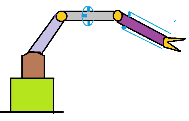

Let's say you have a low force hobby robotic arm that's supposed to perform a certain movement, but it should stop if there is an object in the way. What sort of sensors/solutions exist for this?
I've considered force sensors but I'm not sure if that's the best idea since I'd have to place many sensors all over the arm.
Any suggestions are welcome, thanks in advance.

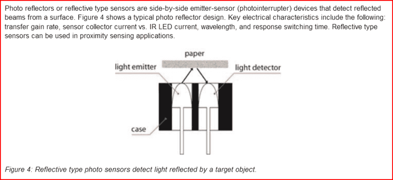

Super! What sensor would work for things such as walls and other solid non living objects?
My first thought would be to use an IR Reflective type sensor to detect when the detector is moving close to some object. I would use IR to avoid lots of extraneous light coming out of the robot arm parts, and I would modulate the IR transmissions (and demodulate the RX signals) to improve noise immunity. This page from Digikey (of all places) is a pretty good tutorial on the different kinds of IR sensors and their uses:
https://www.digikey.com/en/articles/techzone/2012/feb/using-infrared-technology-for-sensing

Bump strips ?

Nik_2213 said:
Bump strips ?
That's what I was leaning towards - a contact sensor.
The blue lines are wires that are connected to a switch, normally open, that close when the wire hits an object.
What the software does with the signal is up to the user - stop the motor, go in reverse, go slow, activate the load sensing routine, etc
The ring would ne connected to multiple switches for 360 degree contact sensing.
A ring could be put on the end of the wires also for 360 degrees..
I imagine contact sensing would be simpler to set up firstly, to flesh out the routines that one might need, and then move up to other sensors after this is down pat .
