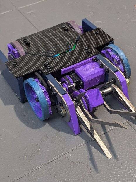

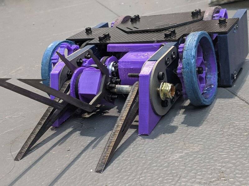

Since there's been a bit of interest, I'll go ahead and share some of the past progress I've made, which is serving as a sort of "starting point" for this stage of the project. This is Morq, my beetleweight combat robot. The version you see here fought twice at NHRL in September, and four times at Makerfaire Orlando in November. In its current form, Morq is a pretty speedy bot; however, now that I have a significant gap before any future competitions, I am spending the time to use my lessons learned to upgrade the robot, and to try my best to add the aero-downforce system that this thread is focused around. Many of the features you see in the images might be likely to change in the redesign, but I'm happy to provide details if anyone feels it might be relevant.
As for the downforce system itself, I'm starting to see a lot of appeal in a "periphery jet" design, based on my readings from the paper I linked above. Essentially, it would eliminate the need for a solid "skirt", which could become snagged on damaged or uneven sections of floor, and would instead push high-pressure air in a thin wall around the entire perimeter of the low-pressure surface. The geometry of the system might be complex, but could be 3D-printed quite easily.
My current dilemma is fan placement. The system described in the paper used a large number of small fans to pull air from the low-pressure volume into the high-pressure chamber; because of the differences in scale, I find it very unlikely that I'll be able to fit more than one or two pressurizing fans, so I'll need to optimize intake placement and other parameters carefully.

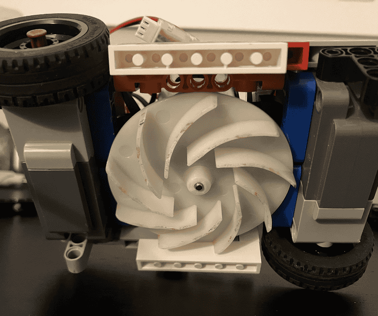

I mocked this up in Lego technic with an impeller fan from a car vac. It doesn't move straight and tends to slide down the wall instead of stick to it in place like the skirted vacuum that I was using before.
Is it better to have straight fins on the disc? I was thinking of 3D printing a disc with strakes like you described. The car totally sucks onto the wall from a couple inches away, but it doesn't quite stay sucked in place unless it's on the ceiling. Should the fins be shorter on the disc than what I have? Should it have any skirting at all, or does that need to ideally be wide open all around?
I found a good example that works very well from the looks of the video, but I don't want to use an expensive EDF if I can get away with something simpler/cheaper.
Suction car robot "Ibex" from Operative RC:​
A car vac is designed to pull a continuous volume of air. That is why it has the big strakes on the fan. The impeller would need some cowl or skirt to reduce the outer edge leakage. The work done to turn a car vac impeller will turn the vehicle, so we need less total surface drag.
I would experiment with a smooth disc, very close to the surface, not yet mounted on a car. Measure the RPM, diameter, and suction down force. There should be some obvious relationships, that will lead to an optimised design. The motor needs to be high RPM, with a lower torque, so it will be longer and thinner, not short and fat.
I expect it will need to rotate fast and have as big a diameter as possible. That will require balancing, so 3D printing will probably not work. The disc will be subjected to high radial forces, so it will need to be strong to avoid bursting. I would make the disc from aluminium or polycarbonate sheet. I am trying to think of a source for a ready-made disc.
It will need to be light-weight, such as polycarbonate, maybe like a CD, but that will need a one-sided hub. An aluminium disc is also possible, something like the flat lid from a saucepan.
There may be a parallel here, with the flat-disc rotors in a Tesla turbine.
Only this idea sucks, as it is not a driven turbine.
https://en.wikipedia.org/wiki/Tesla_turbine
