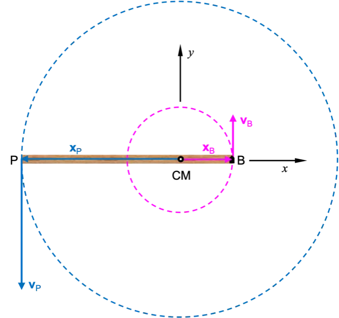

I think we are reading the question differently. It asks for the tension after the impact, not the tensional momentum delivered during the impact.
Seems to me we have to find the motions immediately after impact and deduce the tension from those.
Let the post-impact angular velocity be ##\omega## anticlockwise and the speed of the left end of the rod be ##u## down and left.
The post-impact velocities of the bullet and rod centre can each be resolved as the sum of the velocity of the left end of the rod and a velocity relative to that, the latter being purely in the positive y direction and having magnitudes ##L\omega/2, L\omega## respectively.
For convenience I'll write ##s=\sin(\theta)##. For clarity, I'll write M for the rod's mass.
Conservation of linear momentum normal to the string:
##mvs=-mu+mL\omega s -Mu+ML\omega s/2##
Conservation of angular momentum about P (as a fixed point in space):
##mvL=mL^2\omega+ML^2\omega/3##
so ##L\omega=\frac{3mv}{3m+M}##
Combining:
##(m+M)u=(m+M/2)sv\frac{3m}{3m+M}-mvs##
##=\frac{Mmvs}{6m+2M}##
Now setting M=m we get
##u=vs/16##
##\omega=\frac{3v}{4L}##
From here it gets messy, so less convincing…
The left end of the rod now has acceleration ##u^2/D## towards the fixed attachment point. The rod's mass centre and the bullet have acceleration ##\omega^2(L/2), \omega^2L ## respectively leftwards relative to the left end of the rod.
In the direction of the string, these last have components ##\omega^2(L/2)s, \omega^2Ls## respectively.
The tension in the string is responsible for the net acceleration of the system in that direction:
##T=2mu^2/D+m\omega^2(3L/2)s##
##=mv^2s(\frac{s}{128D}+\frac{27}{32L})##
