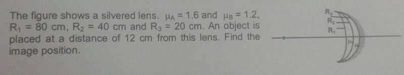

Tanishq Nandan
122
▪1/f=[(n2/n1)-1][1/R1 -1/R2]
▪1/f(eq)=1/f1 +1/f2
For combination of 2 lens
▪1/f(eq)=1/f(mirror) -2/f(lens)
for combination of lens and mirror
▪1/v+1/u=1/f
Mirror formula
I just applied the above equations
1.Finding the individual focal lengths of the two concavoconvex lens using Eq1 (Ccoming as 200 and 400/3)
2.Finding their equivalent focal length using Eq2(coming as 80)
3.Finding equivalent of the lens and mirror using Eq3(coming -40/3).
4.Finally using the simple mirror formula,1/v+1/u=1/f,to find image distance(coming something which isn't the answer)
Is there anything wrong with this method or am I doing any calculation mistake.I MAY have done something wrong with the sign convention while applying Eq1,maybe..maybe not..
Wherever the mistake is,I would be glad if someone points it out.

Hello Tanishq ,
What is the official answer provided ? I have worked the problem .In case my answer matches , I will be in a position to help you .
It's 24cm to the left of the lens.
OK. This is what I am getting .
▪1/f(eq)=1/f1 +1/f2
▪1/v+1/u=1/f
Mirror formula
OK till here .
I think the problem lies here . I don't think that formula is valid .
You have correctly calculated the focal length of the two lenses . You need to treat the combined lens and mirror separately .
For the first refraction at the combined lens , what is the image distance ?
Umm...it's coming 240/23 to the left of the lens..but I doubt its correct..I might be making some mistake in sign convention...formula is 1/v-1/u=1/f...u will be negative,but will f??
If f is negative..it'll come 240/17 to the left.
What value will you put in "u" in the lens formula ?
-12
OK . But that doesn't give v= 240/23 . Recheck your calculations .
What about f?? Should it be +80 or -80?
And 240/23...not 13
+80
Then it's 240/17
Then it's 240/17
Yes . Now this image acts as an object for the mirror . Where is the image located for the reflection from the mirror ?
It's not coming 24,at least..
1/v+1/u=1/f
u is -240/17
f is -20
Anything wrong?
1/v+1/u=1/f
u is -240/17
f is -20
Anything wrong?
But concave mirrors have negative focal lengths..
Yup .It will be negative but not 20 :wink: .
? how..why..
You're right..it should come 8..i think..but how??beats me..
? how..why..
What is the relationship between focal length and radius of a spherical mirror ?
oooooooo..idiot..i was given radius.not focal length
So ,what is the answer to question I asked in post#17 ?
Umm..it's coming 240/7..
Do i need to consider refraction from the lens system again?
Yup .
Now reflected rays from the mirror again suffer refraction from the combined lens .The image of the mirror acts as an object for the combined lens .
Note that , now the rays are traveling from right to left .
Yup..just did it..got the ans..thanks a tonne for bearing with me!
