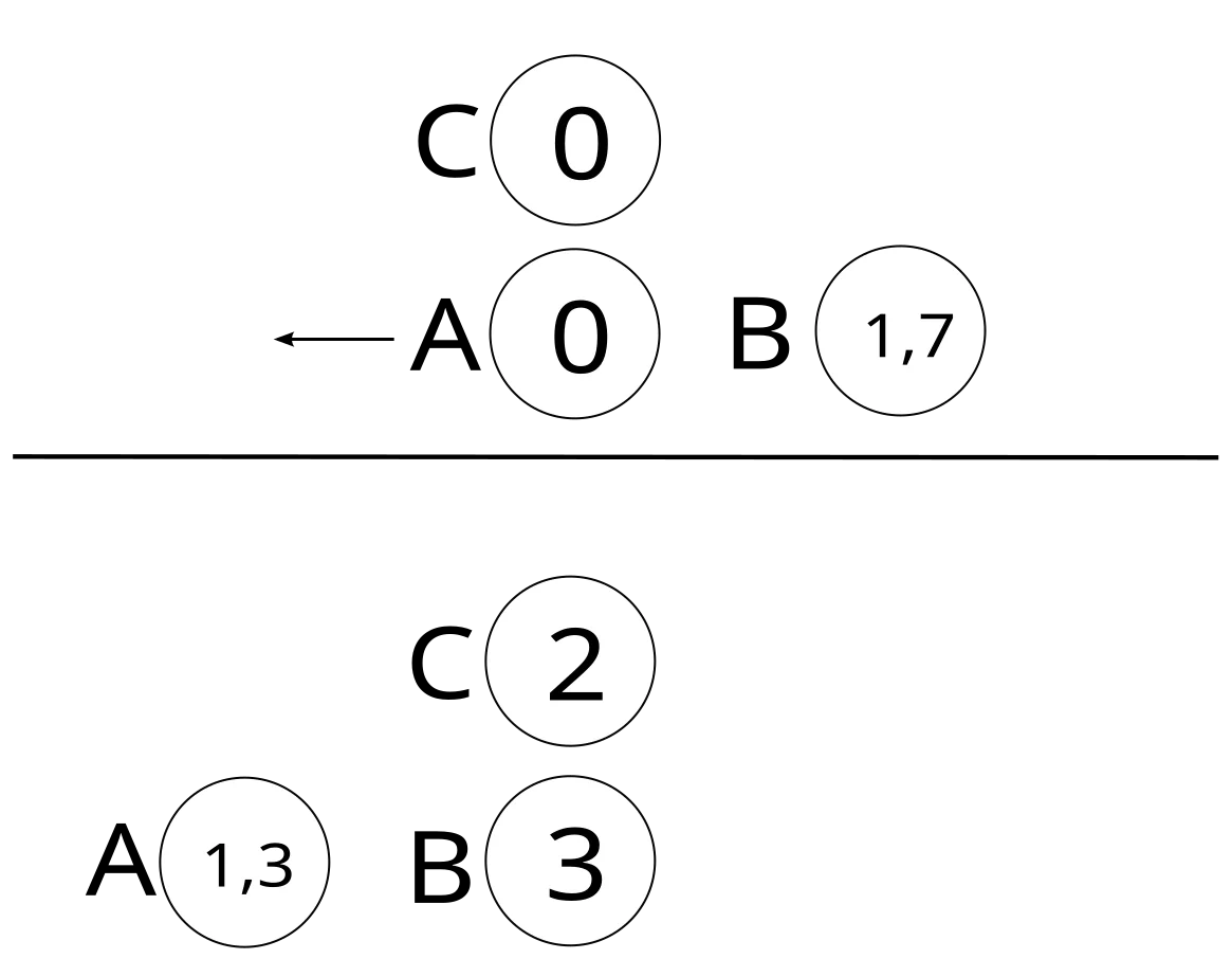

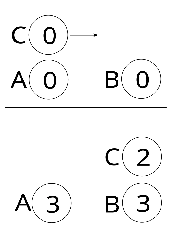

You may have a look at the images in the German Wikipedia that precisely describe, and solve, your scenarios:
In scenario 1 (rest frame of Earth), there is a rocket C traveling between synchronized clocks A and B. When C reaches B the clocks were advanced by ##\Delta C=2## and ##\Delta B=3##, thus $$\Delta C < \Delta B$$.
Space-time diagram of three clocks labelled A, B and C: above a horizontal line, C reads 0 and moves right beside A reading 0 and B reading 0; below it, C reads 2, A reads 3 and B reads 3.
In scenario 2 (rest frame of rocket), A and B are not synchronized because A=0 and B=1.7 at the start due to relativity of simultaneity. When B reaches C they again indicate C=2 and B=3. Yet we know that B=1.7 at the start, so B only advanced by ##\Delta B=3-1.7=1.3## during motion while C advanced by ##\Delta C=2##, thus $$\Delta B < \Delta C$$.
Two-panel diagram of clock readings. Top: clock C reads 0, clock A reads 0 with an arrow pointing left, clock B reads 1,7, with a horizontal line below. Bottom: clock C reads 2, clock B reads 3, clock A reads 1,3.

Histspec, Thanks! In your example ##\Delta C < \Delta B## and ##\Delta B < \Delta C## but in explanation it was written that ##\Delta C < \Delta B## in both scenario.
As you can see on the images, in both scenarios the clock indications of B and C when they meet are B=3 and C=2, thus $$C=2<B=3$$
But time dilation is about intervals, which gives (as explained above) $$\Delta C=2 < \Delta B=3$$ in scenario 1, and $$\Delta B=1.3 < \Delta C=2$$ in scenario 2 .

Histspec, Why "When B reaches C they again indicate C=2 and B=3"?
In Scenario 2, clock C indicates 0 at the start, advances by interval 2 during motion and therefore indicates time C=2 when it meets B; and clock B indicates 1.7 at the start and advances by interval 1.3 during motion, thus B indicates B=1.7+1.3=3 when it meets C. What's the problem?
