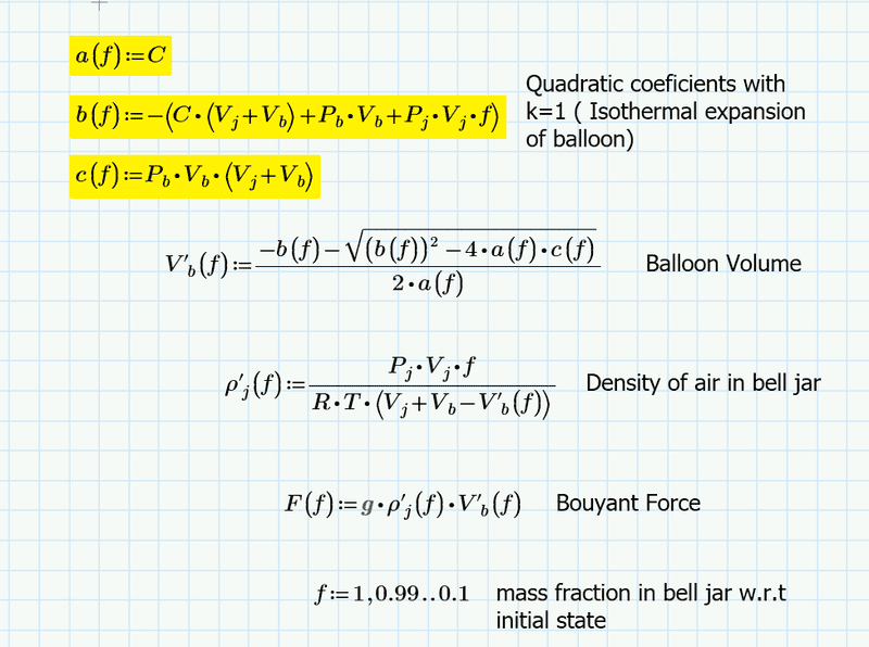

ok, then when we decrease then amount of air in the jar, the ballon expands the displaced air volume goes up, but the density of the displaced air goes down i.e. there is less air in the same jar. So what is ##F_b## doing, I think its declining in magnitude, because I expect there to be no buoyant force in a perfect vacuum - thus, increasing the readout on the scale?
Reply
What the buoyant force does in that case would be hard to predict, and it would depend upon just how much the balloon expands as the external pressure is lowered. If the balloon expands enough, the buoyant force could increase. If you make a vacuum, yes, then the buoyant force would be zero.
So then it's fair to say that there is something complicated occurring if you think it won't necessarily monotonically decrease toward zero. I'm a little bit - :oldconfused:
For a "rigid balloon" (I expect) it decreases monotonically as the air is evacuated. What is it about the rubber?

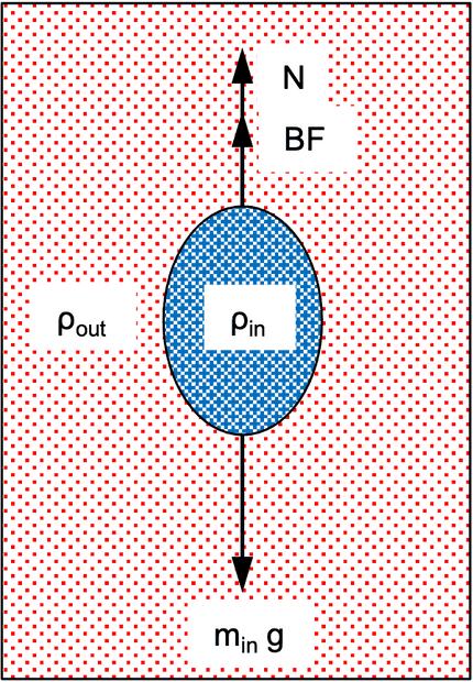

erobz said:
The scale reading inside is unpredictable . . .
In what sense unpredictable? If you know the parameters on which it depends, then it can be predicted. From the FBD of the balloon on the right we have $$N+BF-m_{\text{in}}g=0 \implies N=m_{\text{in}}g-BF.$$ The normal force is the reading of the scale ##R##. In terms of the densities of the air inside and the air outside the balloon and the volume of the balloon, we have $$\begin{align} & R=\rho_{\text{in}}V_{\text{bal}}g-\rho_{\text{out}}V_{\text{bal}}g\nonumber \\
& R=\left(1-\frac{\rho_{\text{out}}}{{\rho_{\text{in}}}} \right){m_{\text{in}}g}.
\end{align}$$ The last expression assumes that the scale has been tared to subtract the weight of the balloon. We write the density as ##\rho=\dfrac{N\mu}{V}## where N is the number of air molecules and ##\mu## the mass of a single molecule. Then the ideal gas law becomes $$p=\frac{\rho}{\mu}kT.$$Because ##p_{\text{in}}>p_{\text{out}}## (otherwise the balloon would not be inflated) it follows that ##\rho_{\text{in}}>\rho_{\text{out}}.## In that case equation (1) predicts that the reading on the scale will always be less than the weight of the gas inside the balloon as air is sucked out of the bell jar. To get an exact number, one would have to know the density ratio.

kuruman said:
View attachment 356851In what sense unpredictable? $$Because ##p_{\text{in}}>p_{\text{out}}## (otherwise the balloon would not be inflated) it follows that ##\rho_{\text{in}}>\rho_{\text{out}}.##
One minor correction : If the air inside the balloon is of a lighter atom or molecule, such as helium (He) or hydrogen (## H_2 ##). Then the scale reading can actually be negative, i.e. if you attached the balloon to the scale with a string, it would pull upward.
The point is that, without more information on the condom, you cannot determine ##\rho_{\rm in}##. The condom volume - and therefore the density of the air inside - will depend on the elastic properties of the condom. The important thing to know if you want to know if the reading increases or decreases as you suck the air out is not knowing the density ratio - it is knowing how the density ratio changes as you change ##\rho_{\rm out}## and to know that you need to do some modelling.
Essentially, taking a spherical condom and defining ##p_{\rm out}/p_{\rm in} = x## I believe you would get something like$$
x= \frac{Rp_{\rm out}}{{R p_{\rm out} +{\sigma(R)}}}
$$ where ##\sigma(R)## is the dependence of the surface tension as a function of size ##R##. If ##\sigma(R)## grows linearly with ##R## then ##x## would decrease with ##p_{\rm out}##, meaning the scale reading would increase as you suck the air out. However, I do not think a condom has a linear ##\sigma(R)## ... In the limit of constant ##\sigma(R)## you would find ##x \propto R^3## and the reading would decrease when you suck the air out.
