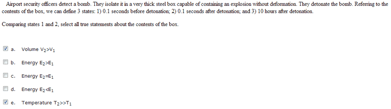

Comparison of T, E and V in different states?
  • Thread starter Thread starter theBEAST
    Comparison States
3 replies · 1K views
theBEAST
361
I currently think that a and e are correct. But I am not sure what happens to the energy IN THE BOX. When the box explodes, the energy of the contents changes from potential to thermal, sound and kinetic energy. Thus by conservation of energy there is no change in energy of the contents...
Am I right?
Thanks!
There's probably some debate room on a few of these. But why did you check a) if they specifically said in a box that will contain the explosion without deformation? And if you say there is no change in the energy inside the box, why didn't you check c)? Not sure I get the logic here. Surely ONE of b,c or d must be true? I mean they contain all possibilities.
OH, I totally did not see that. Alright so the volume remains constant, and the temperature increases drastically. In those 0.1s, the energy is conserved so I will pick c and e.
That's plausible and probably approximately correct. But if you've got sound energy generated inside the box it could probably get out in less that 0.1 sec, yes? This the 'debatable' thing.
