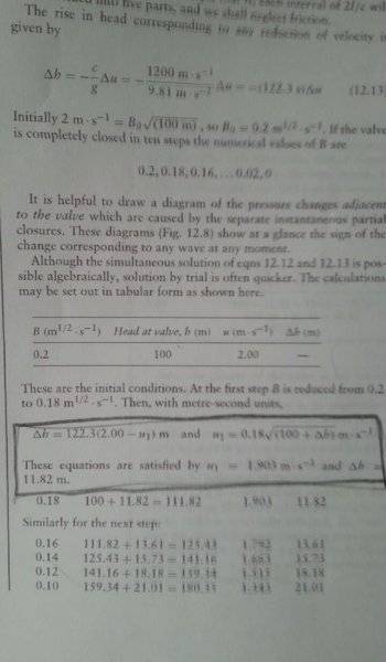

The overall question is on non steady fluid mechanics however the part on stuck on boils down to the two equations below, which I am unable to solve.
X = 122.3 (2 - Y)
Y= 0.18 * SQRT( 100 + X )
the text states the equations are satisfied by Y = 1.903 and X = 11.82.
To prove this isn't a homework I will upload a picture of the solution given.
Regards

It is still like a homework question.
If you solve the first equation for Y, square both equations and set them equal, you get a quadratic equation for X. Solving this gives the solutions for Y afterwards.
The page its from is actually a question solution however they didn't explain how to solve that particle part.
I did as you said earlier, however, the b^2-4ac section came out negative so I was unsure I was going in the right direction.
Anyone able to advise?
Regards
*Particular
Sorry
Then you have a calculation error somewhere, as the approach works.
