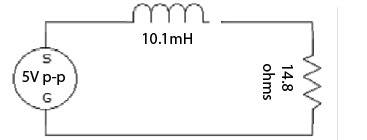

gneill said:
Is there a particular circuit configuration that we should know about? :smile:
Lol I'm not sure, but here it is:
PS, this is an intro-lab if that wasn't obvious enough. lol

You don't want to mix p-p and p quantities. Choose one "type" for your computations and stick to it.
Something misfired in your complex number calcs above; The result looks off.
Also, if I go by the 5Vpp @1KHz source and the given component values, the magnitude of the current that I calculate would be about 77 mA p-p, or 38 mA peak. So something is fishy about your "measured above" values or the component values.

Well, it depends upon what it is you're trying to calculate. Make a clear statement of what it is you're trying to determine. If it's the magnitude of the current flowing through the resistor, then Ip = Vp/R, or Ipp = Vpp/R, where both Vp and Vpp are measured across R.

$$\frac{2.5\;V}{14.8 + 63.46j \; \Omega} \cdot \frac{14.8 - 63.46j}{14.8 - 63.46j} → \frac{37 - 158.65j}{4246}\;A = 8.71 + 37.36j \; mA $$

That might not be a bad idea. You might want to determine at least the order of magnitudes to expect for the values. Also confirm the part values and supply frequency. If you have an Ohmmeter handy, check to see if the inductor has a non-negligible resistance.
When using an oscilloscope, always check to see if any scope probe you're using has a scaling factor associated with it (quite often they divide by ten).
For the current that you measured, what type of instrument did you use? Was it an ammeter? Does it provide values in peak or RMS? (typically they present RMS values assuming a sinusoidal signal).
Supposing that R = 14.8 Ω, L = 10.1 mH, and f = 1 KHz, then what do you think you should see for the voltage across the resistor?

You can treat the impedance of the inductor just as you would a resistance as far as the usual circuit equations are concerned. The only difference is that you'll be dealing with complex values in the calculations.
Your two components (resistor, inductor) are going to behave like a voltage divider. So if E is the input voltage and R and ZL the impedances of the parts, what voltage should you expect across the R?
I'm not sure. Sorry for being ignorant, but there was no "intro to EE" class before this lab course. So I'm learning as I go.
If you can calculate the (complex) current, then you can determine the (complex) voltages for the individual components via Ohm's law. Their magnitudes should match those of the traces you see on the scope.
