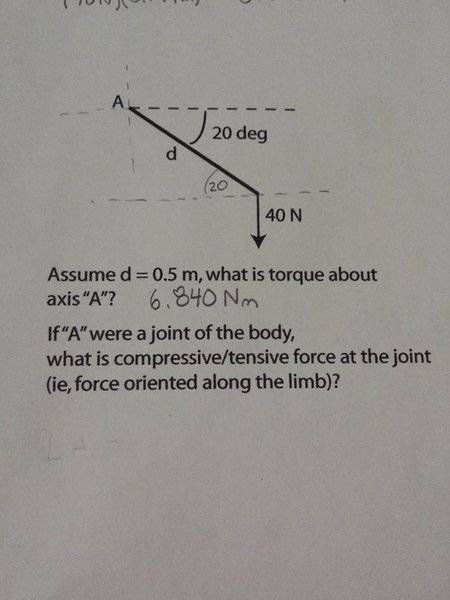

If "A" were a joint of the body, what is the compressive/tensive force at the joint?
I already figured out the torque about A to be 6.840 Nm, but I'm not quite sure how to go about figuring out compressive/tensive forces. Normally, there would be a force associated in the area or angles would be given, but there is no other information.
hi cdornz! :smile:
you misssed out "(ie, force oriented along the limb)" …
that's all you need to find, the component of the force (at A) along the limb (the thick line) :wink:
if it's away from A, it's tensive, if it's towards A, it's compressive
(and this has nothing to do with torque)
