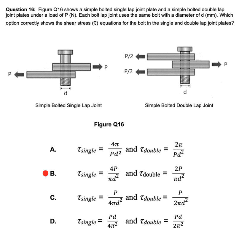

See image below
Stress = force/area
Here is a MCQ which I'm struggling to answer
The option with a red dot is the answer I chosen and think is right
I know that stress is equal to force/area
Area i.e. the cross sectional area of a circle is (pi*d2)/4
Looking at the simple lap joint, force is simple P netwons
hence stress is P/(pi*d2)/4 giving 4P/(pi*d2)
Not so sure about the double lap joint, but I think force must be P/2 Newtons, hence stress is (P/2)/((pi*d2)/4 = 2P/pi*d2
Thus giving me option b as the answer. Is this the way you work it out?
Thanks in advance!

I agree with your answer. You can think of the double joint as two singles, each with force P/2.
I must admit I found it hard to interpret the diagrams. This link made it much clearer to me to me what was going on, and so I realize we are looking for the shear stress in the horizontal cross section in the plane between any two plates. Then you can consider drawing a FBD of the bolt, and then making a "slice" to the bolt in one of those planes and inserting internal constraint forces (which here are shear forces). That then allows you to calculate the shear stress.
