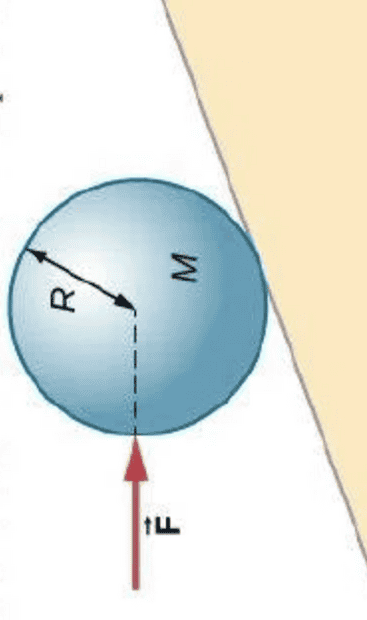

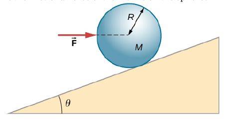

A horizontal force ##\vec{F}## is applied to a uniform sphere in direction exact toward the center of the sphere, as shown below. Find the magnitude of this force so that the sphere remains in static equilibrium. What is the frictional force of the incline on the sphere?
##\sum{\tau} = 0 ##
##\sum{F} = 0 ##
So if I understand correctly the forces acting on the sphere are ##\vec{F}##, the normal force, friction, and the weight of the sphere. In order for the conditions of static equilibrium to be met the net torque must be zero.
The torque about the center of the sphere created by the normal force, the weight force, and ##\vec{F}## are all zero because the angle between their position vectors and themselves are zero (rFsin0 = 0). The only other force is friction which acts along the incline. So if friction is nonzero, then net torque is nonzero which contradicts the premises of the question?
Any help is appreciated.
.. and therefore the conclusion must be …
That there is no friction I suppose. To me the question's wording seems to imply that there's nonzero friction but I guess not.
The question does imply that. However, just like the normal force, static friction adjusts itself to provide the observed acceleration.
Say force ##\mathbf F## is applied to the sphere with a horizontal rod and the contact between rod and sphere has coefficient of static friction ##\mu_s.## If friction is not needed to provide zero acceleration, then the specific value of ##\mu_s## is irrelevant; the answer is the same.
Your solution is incomplete. You have shown that the sphere can be in rotational equilibrium when the friction is zero. This does not necessarily mean that the sphere is also in translational equilibrium. How do you know that, with zero friction, the sum of the forces can be zero? In other words, show that there is a value of the normal force such that the net force on the sphere is zero.

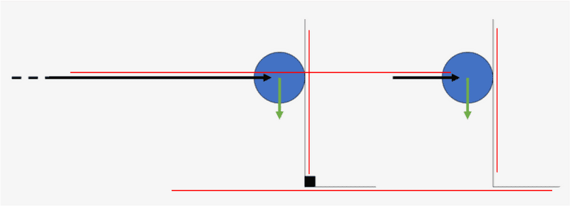

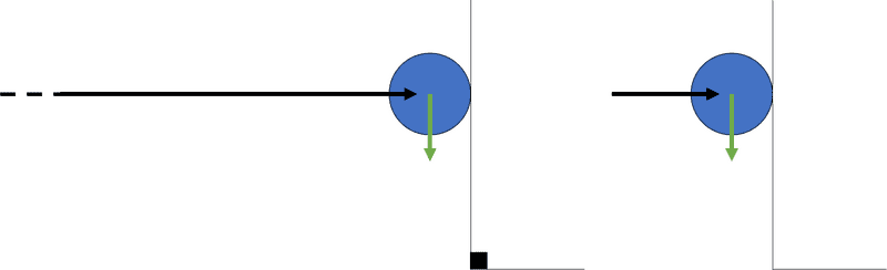

There is something I could use some convincing on...make the angle ## \theta = \frac{\pi}{2}##, this seems problematic without friction, and it also seems problematic with friction at the same time? It seems to be that it can only be achieved if there is a vertical frictional force at the point of application of ##F##?
There are two "fixed" forces with respect to ##\theta## acting on the sphere, the vertical weight ##\mathbf W## and the horizontal force ##\mathbf F##. If we exclude friction, then the normal force must be equal to the vector sum of the two fixed forces in order to have equilibrium, $$\mathbf N=\mathbf W+\mathbf F.$$ This condition can be satisfied as long as the normal force is not collinear with ##\mathbf F.## It breaks down at ##\theta=\frac{\pi}{2}.##
However this 90° rotation would work (gravity is still from the top of the screen to the bottom.)
There is something very unsatisfying about it failing precisely at ##\frac{\pi}{2}##. We do the "push box on the vertical wall problem" regularly, friction is the objective reality there. Now, replace the box with a sphere and it goes to hell in a hand basket...
I don't see it that way. You start with two forces, one horizontal ##\mathbf F## and one vertical ##\mathbf W.## As long as the normal force can have a horizontal component to match ##\mathbf F## and a vertical component to match ##\mathbf W##, there can be equilibrium with zero friction.
This condition cannot be met precisely at ##\theta = 0## at which ##\mathbf N## cannot have a horizontal component and at ##\theta = \frac{\pi}{2}## at which ##\mathbf N## cannot have a vertical component. Any other angle between the two extreme values works with zero friction.
At the specific value ##\theta = 0##, if there is no friction, the sphere will slide to the right with acceleration ##a=F/m.## At the specific value ##\theta = \frac{\pi}{2}##, if there is no friction, the sphere will slide straight down ##a=g.##
At the specific value ##\theta = 0##, if there is friction, the sphere will slide to the right with acceleration ##a=F/m.## If there is friction, and ##F<\mu_s mg##, the sphere will roll without sliding to the right with acceleration ##a_{cm}=\frac{5}{7}(F/m)##. This requires ##f_s=(2/7)F## to the left.
At the specific value ##\theta = \frac{\pi}{2}##, if there is no friction, the sphere will slide straight down ##a=g.## To have equilibrium if there is friction, an additional assumption needs to be made that force ##\mathbf F## is applied with, say, a horizontal rod and that the contact is "rough". Then, as long as the relevant coefficients of static friction are high enough to have no slipping, at the points of contact with the rod and the wall the upward forces of friction are equal (this balances the torques about the center) with a value of ##\frac{1}{2}mg## each to balance the weight. The horizontal force is balanced by the normal force. Nothing goes to hell in a hand basket.

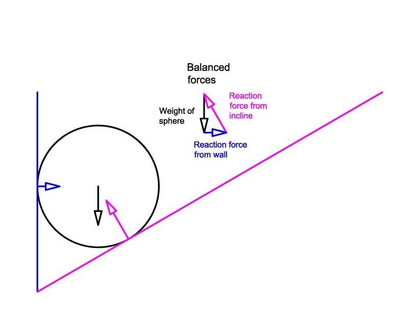

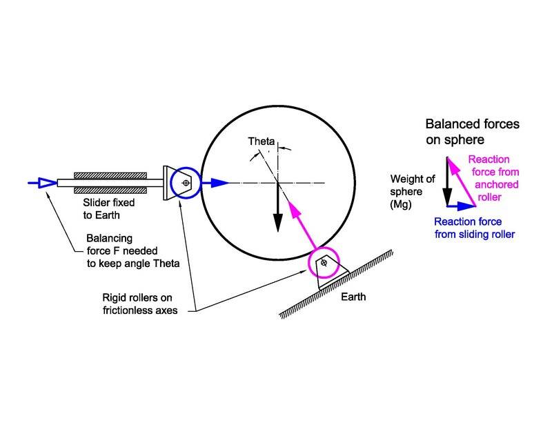

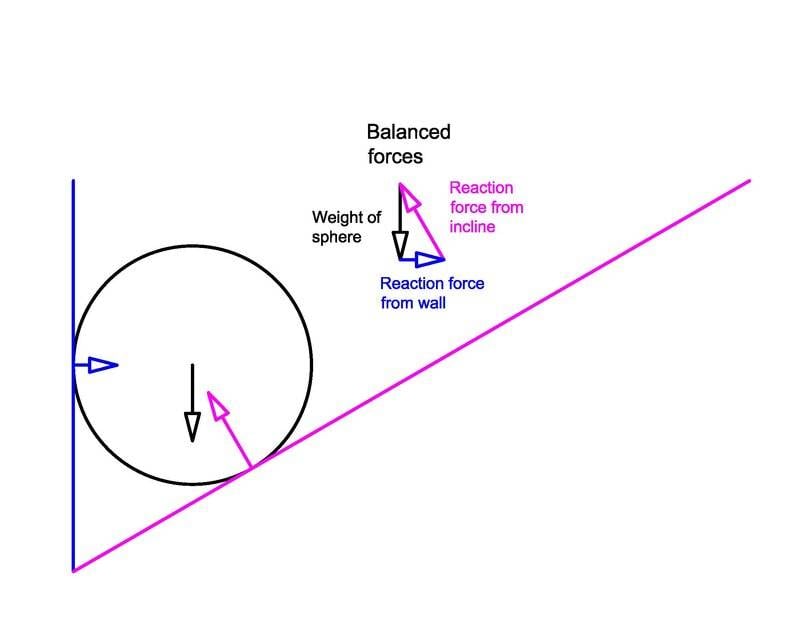

If we replace F with a vertical wall, we are creating a geometrical restriction (two converging planes) for the sphere to move or rotate under the action of its own weight.
Friction force is always a natural reaction to imminent of fully developed movement.
No relative movement sphere-wall-incline = No friction forces

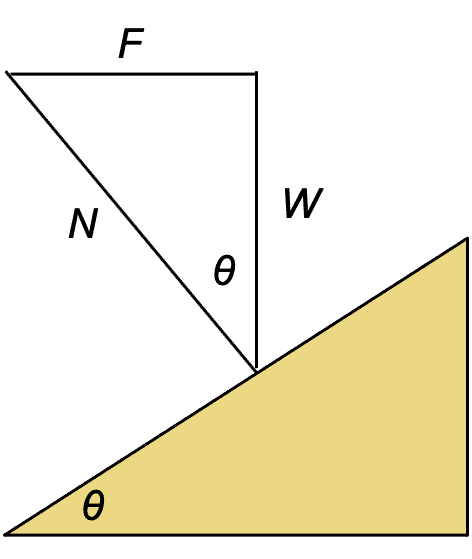

OK, let's check the limits. Look at the FBD on the right. From the right triangle obtained by adding the three forces, the equilibrium relation of magnitudes is $$\tan\theta=\frac{F}{W}~~~(N=\sqrt{F^2+W^2}.)$$
When ##\theta=0##, (##\tan\theta=0##), we must have ##F=0##. That makes sense and is consistent with ##~\mathbf F_{\text{net}}=m\mathbf a~##. In the vertical direction ##\mathbf N=-\mathbf W##. Unless ##F=0##, there cannot be equilibrium because ##\mathbf F## is the only horizontal force.
When ##\theta=\frac{\pi}{2}##,(##\tan\theta=\infty##), we must have ##W=0##. This, too, makes sense and we can apply similar reasoning as before but with the directions swapped. Here, the normal force becomes horizontal and can easily balance the pushing force, ##\mathbf N=-\mathbf F.## Unless ##W=0##, there cannot be equilibrium because ##\mathbf W## is the only vertical force.

View attachment 356361OK, let's check the limits. Look at the FBD on the right. From the right triangle obtained by adding the three forces, the equilibrium relation of magnitudes is $$\tan\theta=\frac{F}{W}~~~(N=\sqrt{F^2+W^2}.)$$

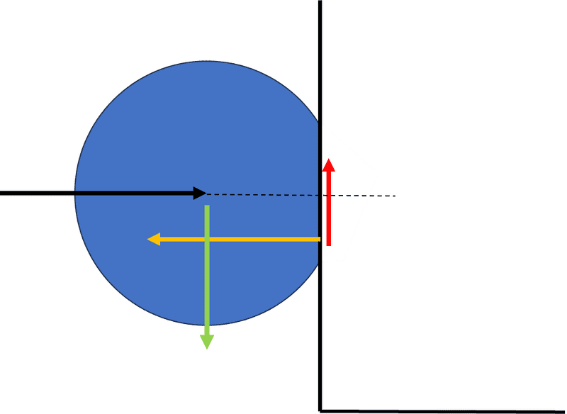

I'm not deniying any of that (I belive). This is what I'm trying to get across as fishy:
The one on the right has a solution for ##F## that is finite. The diagram on the left does not. This model of "no required friction" would seem to do poorly at some point.
It's not just friction appearing at the wall-ball interface that resolves this because there would still be a net torque unchallenged. At a minimum it requires both friction and deformation, such that the normal force can be offset (countering the torque from the weight at the wall) that an equilibrium can exist.

The right side has a finite ##F##, look closely at the angle diagram and it should illustrate my point. (The normal forces are not show here for clarity but it really makes no difference). I'm saying that the right side has a solution according to the mathematics, but the left side diagram does not - can you prove me wrong(rhetorical question I hope)? Anything that gives an infinite change from an infinitesimal displacement do you truly believe to be a viable physical model?
I looked closely and I didn't see any difference in the angle. I added my own perpendicular lines (in red) to your diagram and they look parallel to yours.
