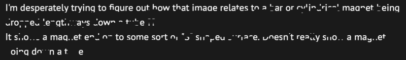

My HP laptop screen is intermittently misbehaving 3 or 4 times per day. See an example below. But if I scroll that text off screen, then scroll back again, it renders correctly.
I'm wondering if it just might be a faulty connection.
Should I try to unplug/plug the cables to the screen?
Should I try to re-seat the memory chips?
What other DIY remedies might I try?

It looks like the font data is corrupted which could mean a bad disk sector.
Then the graphic card drivers are OK. To me it looks like a video RAM problem - which again means the graphic card subsystem.
Likes Yelzobj and anorlunda
I disagree with the font data problem theory. Characters appear good some places and bad other places. Reseat the easiest connections first. Reseat everything before you consider other hardware problems.

Yeah I noticed that as I looked at it again today and started thinking maybe it’s an issue of graphics updates to the screen as the mouse pointer moves across it.

If you can connect another monitor through HDMI or other, try that. It may narrow down the possible source of the problem.
No, not the font data. If that were the problem, we would see consistent corruption: all L's should have the same corruption everywhere in the text (see below). Same with all T's, etc.
(Though, oddly, there is consistency with double letters, such as dropped, really, and !)
It does seem to be related to character rendering to-screen. As if, for every character sequentially printed to the screen, a random number of raster lines just doesn't light up.
Notice that its always a line of pixels missing from a character - never individual pixels.
That sure points to contents of the Video Ram. Could be either reading the Character Generator or writing the VIdeo Ram. My first step would be clean all the dust out of the thing, memories don't like hi temps (all they have to sweat is bits, and that's what gets dropped). Hi temps can also disrupt the timing of the interface chips, giving identical visual effects.
Then you can move on to wiggling everything in a socket or connector. Tthough it's probably best to keep clear of the CPU other than dusting it off.

Is this a particular program?
Does it happen in the BIOS? Or in another operating system (e.g. linux live cd)?
Did you make any change recently or it started showing sudden?
