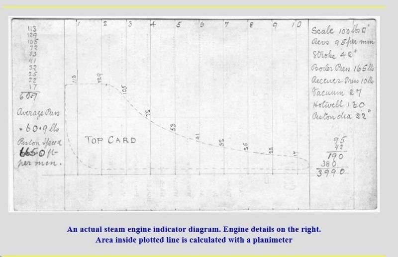

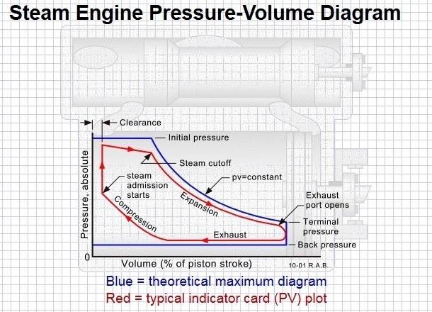

If you can find a Marks Mechanical Engineer's handbook frm 1920's to 1940's there is an interesting chapter on "Carding" of reciprocating steam engines. Basically that's making a PV diagram by actually recording pressure versus piston position. It's how you optimize a stationary engine.
What fun it would be to watch that real time at various loads and valve timing !
snip of an actual "card"
http://www.oldengine.org/members/diesel/indicator/Indicator1.htm
http://trumpetb.net/loco/steampv.html
Check "Florida Flywheelers" antique engine show , February in Zolfo Springs.
