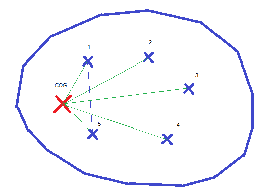

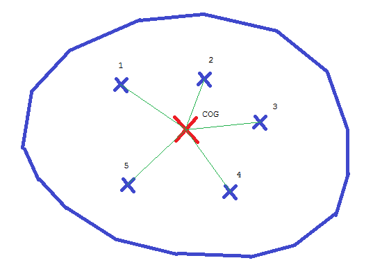

Hello,
I would like to ask the following question :
--> I have an object of mass M (represented by the blue potato in the two attached drawings).
--> I know the coordinates (x,y) of its Center of Gravity (reprensented by big red cross).
--> I also know the coordinates of its contact points to the ground (reprensented by the 5 bleue crosses).
(In this example, there are 5, but it can be more .. or less)
I would like to know how to compute the mass distribution amongst the various contact points.
(I assume that depending on where the COG lies in my Object... some contact points might act as a lever on the others and raise them from the ground).
Thanks in advance.
Enrico.
Diagram of a blue irregular blob-shaped object with five numbered blue contact points 1 to 5 around its edge, connected by thin green lines to a red cross labelled COG near the centre.
Diagram of a blob-shaped object outlined in thick blue with a red cross for its centre of gravity and five blue cross contact points numbered 1 to 5, joined to the centre of gravity by green lines, with a blue line from point 1 to point 5.
What you are describing is a statics problem - you should be able to think your way through it by comparing with the work you've probably done with a beam on supports.
