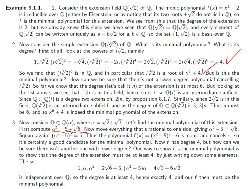

See attached
Am going through this notes...kindly let me know if there is a mistake on highlighted part. I think it ought to be;
##α^2=5+2\sqrt{6}##
chwala said:
Summary: See attached
##α^2=5+2\sqrt{6}##
You are right. It is a mistake in the book and should be ##\alpha^2=5+2\sqrt{6}.## It is the correct value on the list at the end again. The procedure itself is correct.

Thanks...let me peruse through...
