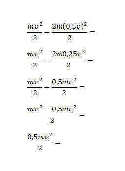

Car 1 (500g) collides with car 2 (500g). The initial velocity of car 2 is 0. The cars stuck together after the collision.
I have to come to a conclusion about the results that i got.
Kinetic energy before: 0,233
Kinetic energy after: 0,125
Delta kinetic energy: 0,108
I also calculated delta Ek with an equation. (I will insert a picture)
So my conclution is that the energy that is "wasted" is half of the energy that we had in the biginning.
I did the same experiment but Car 1 had a mass of 700g and car 2 remained the same. delta kinetic energy was 0,112 which is almost the same as in the first one. So I guess that delta energy is the same no matter how much the cars wheigh. Is my assumption correct?
Should I add anything?
You have not stated your uncertainty at all. Such a generalization based on one experiment without uncertainty is unwarranted. Can you do some more tests?
To address your question: you can work out the energy loss during a completely elastic collision. Note that this depends on the frame of reference. If you analyze the collision from the center of mass frame you can work out the maximum energy loss.
I'm sorry i didn't understand anything. I am not a native speaker. But no i cannot do more tests unfortunately. In my lab report i have written: "the lost energy is the same in both test but I need more tests to come to the conclusion that it remains the same even though the mass differs"

Calculate delta KE for the second experiment and see if it agrees with your data.
I did. the first test was 0,108 and delta Ek on the second test was 0,112 so is it right?

Can't say without more data. What was the initial KE for the second test?
0.345
And initial velocity of 700g car?
0,962 was the initial velocity
it was a 753g car to be more specific
And velocity of 735g and 200g cars after collision?
Sorry i messed up the numbers...
This is test number 2:
Car 1
m = 0,753 kg
V0 = 0,962 m/s
Car 2 had the mass of 0,503 kg
Their total mass after the collision is 1,256kg
V1 = 0,613 m/s
V1 is their velocity after the collision
What is the theoretical V1 (from conservation of momentum)?
it should be 0,745
0,962^2 * 0,753/2 = v^2 * 1,256/2
No. m1v1=m2v2
right i forgot
it should be 0,5767
With this V1, calculate theorectical final KE.
it should be 0,209
Right. And your experimental final KE?
0,236
Right. I would conclude that your experiment is not accurate enough to reach a conclusion on a pattern for delta KE.
You can now easily calculate delta KE for various masses and velocities and reach a theoretical conclusion.
Thank you sosososososo much for helping me :)
i did this on the first test and my theoretical final velocity should be 0,492 but Mine was 0,499
it is pretty close so what should i do with this one?
Either redo it or discuss the problem with the result.
i can't redo it :( my friend told me that they got delta Ek to 0,206 and 0,208 so I suppose that delta Ek should remain the same... but something was defintly wrong with my velocity because the momentum has to be the same but it wasnt

So your friend used different weights and velocities?
yes
Did your friend check the data and results against theory, like you did?
He probably didn't :( I'll check with him tomorrow! It is past midnight :P I hope you are still able to help me tomorrow and thank you for everything
