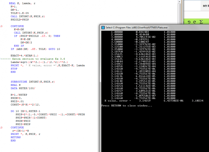

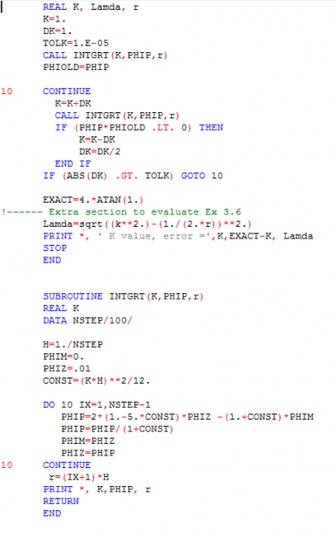

This problem comes with an existing fortran program (copy is viewable at http://mathhelpboards.com/redirect-to/?redirect=https%3A%2F%2Fdrive.google.com%2Ffile%2Fd%2F0B8djt9QSh5rAWldCekRoOGJKVkk%2Fview%3Fusp%3Dsharing) that I must adapt to the situation above. That program outputs the eigenvalue k for the Eq. $$ D^2\phi + k^2\phi=0\:(General\: solution\:is\: k_{n}=n\pi) $$
What I have tried is to substitute: $$ \lambda = (k^2 + (\frac{1}{2r})^2) $$
...so that their program gives me lambda, and then I find k by substituting back into the above eq. I also need to know r, so I adapted their sub to return r.
They have also provided the value I should get - 2.404826. However, I get nothing close to that - see the adjusted program plus output below. If I am doing the right thing above, then the r value I am calculating is wrong, but I can't see why?
Would really appreciate being able to finish this one, thanks
Looks as if r is a constant in your program: the upper bond of the integration.
Instead you want to have r = ix * h (or r = ix +1 * h) inside the loop, so it really takes part in the whole range.
Initial conditions for ##\phi## are needed anyway to make the function behave decently at r = 0 (cf here).
So you want to be very picky with the first two (I think you call them phim and phiz, not really sure)
