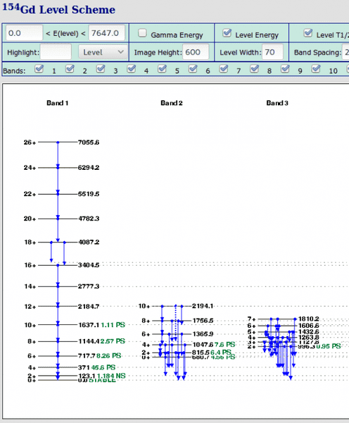

Deformation can be observed by the level structure. For example, the existence of a rotational band is evidence of deformation. As an example, check out the ground state band of 154Gd (just chosen randomly as a nice midshell deformed nucleus. This is a screenshot from NNDC http://www.nndc.bnl.gov/chart/reCenter.jsp?z=64&n=90). The presence of rotational bands are indicative of deformed nuclei.(ETA: Of course there are others, e.g. transition strengths, intruder states, vibrational bands)
Screenshot from 2016-10-20 10:37:04.png
I'm surprised you did not find any experimental work, considering that it is an extremely active field. Here's a (very random) selection of papers that concern experimental data for deformed nuclei. (Some of these are theory papers, but do include experimental data. I've literally just randomly grabbed these from the recent PRC issues and a workshop I was just at. These do not represent a complete coverage of the field in any way)
