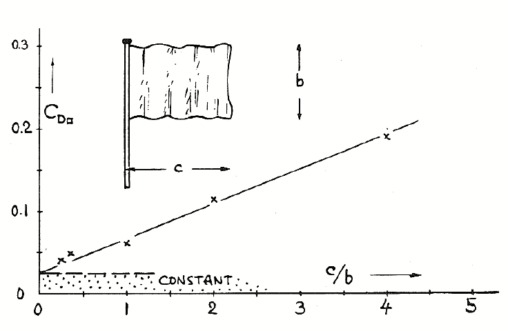

Are there any analytical / mathematical methods to find the drag coefficient of an object that deforms during motion (e.g. a piece of paper travelling through air).
If not (as I suspect), how easy would it be to determine / approximate it experimentally?

To come up with a fully analytical solution to a fluid structure interaction (FSI) problem like this would win you a guaranteed Nobel price, so I'm not going to attempt that :). To compute the drag of any object fully analytically already is a momentous task for anything more complex than a flat plate in laminar flow, let alone if the object moves...
Note that the Rayleigh's drag equation is actually a semi-empirical equation where the Cd is determined experimentally. But we can get some notion of this value if you compare it to a flag on a flag pole. This does mean that instead of fixing the paper to your hand you need some kind of pole to make the comparison work. However, the famous work by Hoerner 'Fluid-Dynamic Drag' already provides a figure for the Cd value (I got this from an otherwise irrelevant paper, not from the book):
I suppose (hope...) that the A used in the drag equation is b*c, but I didn't check.
If you want to do the measurements yourself I would suggest attaching the paper to some kind of pole and put it into some kind of home-made wind-tunnel. Which is actually very hard to get right, but that also depends on the accuracy you're after :).
Good luck!

Thanks! I suspected as much... approximations here I come!
I'd call it a hard no even if you attends a few years of school for engineering.
Whether measuring it is "easy" depends on the fidelity you need. You could just drop it and measure it's terminal speed, but the error bars will be huge as it moves in all directions in the complex flow field. It likely will change speeds a lot as it's orientation changes. You could get a sort of average drag coefficient, I suppose.
Anything more accurate would need a more careful definition of the problem.
