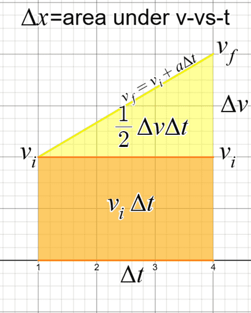

[itex]\begin{align*}\Delta x&\stackrel{const\ a}{=}v_i\Delta t+ \frac{1}{2}\Delta v\Delta t\\<br /> &\stackrel{const\ a}{=}v_i\Delta t+\frac{1}{2}(a\Delta t)\Delta t\\<br /> \end{align*}[/itex]

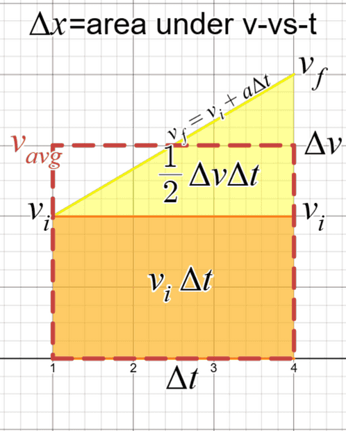

[itex]\begin{align*}\Delta x<br /> &\stackrel{def}{=}v_{avg}\Delta t\\<br /> &\mbox{where $v_{avg}\stackrel{const\ a}{=}$}\left(\frac{v_i+v_f}{2}\right)<br /> \end{align*}[/itex]

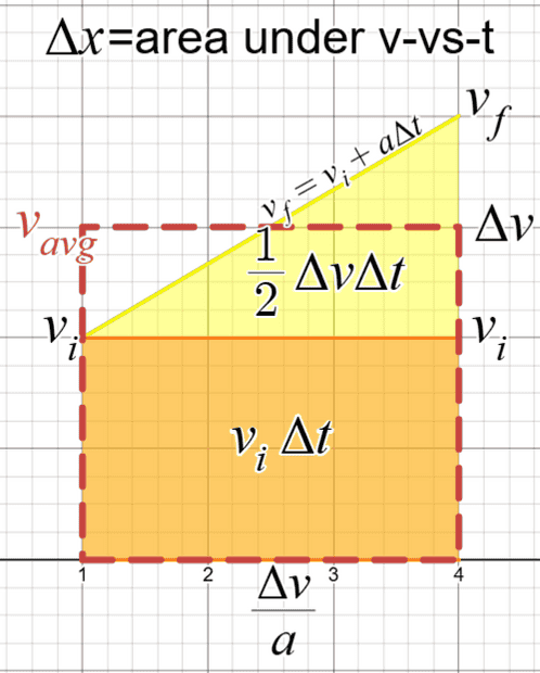

[itex]\begin{align*}\Delta x<br /> &\stackrel{def}{=}v_{avg}\Delta t \stackrel{const\ a}{=} v_{avg} \left(\frac{\Delta v}{a}\right)<br /> \end{align*}[/itex]

View attachment 351557[itex]\begin{align*}\Delta x&\stackrel{const\ a}{=}v_i\Delta t+ \frac{1}{2}\Delta v\Delta t\\<br /> &\stackrel{const\ a}{=}v_i\Delta t+\frac{1}{2}(a\Delta t)\Delta t\\<br /> \end{align*}[/itex]
View attachment 351558 [itex]\begin{align*}\Delta x<br /> &\stackrel{def}{=}v_{avg}\Delta t\\<br /> &\mbox{where $v_{avg}\stackrel{const\ a}{=}$}\left(\frac{v_i+v_f}{2}\right)<br /> \end{align*}[/itex]
View attachment 351559[itex]\begin{align*}\Delta x<br /> &\stackrel{def}{=}v_{avg}\Delta t \stackrel{const\ a}{=} v_{avg} \left(\frac{\Delta v}{a}\right)<br /> \end{align*}[/itex]

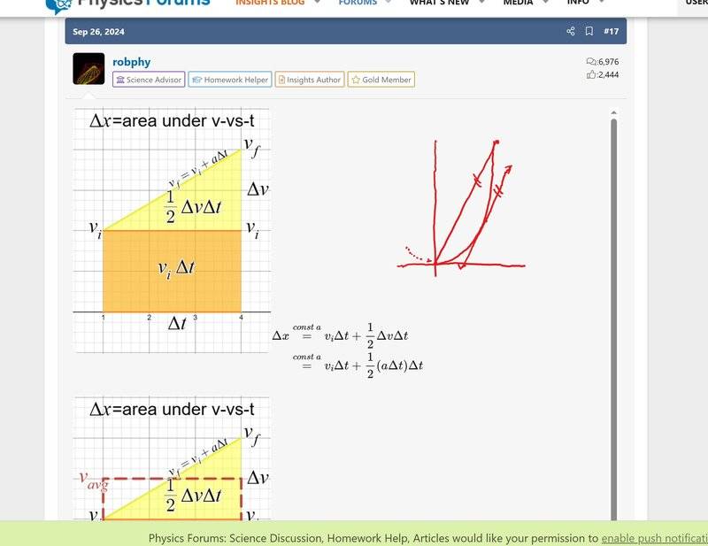

These are some nice visual aids, what program did you use to make them? My visualization for why v average can be used is a bit different tho.
John3509 said:
These are some nice visual aids, what program did you use to make them? My visualization for why v average can be used is a bit different tho.View attachment 351935
Thanks.
I used Desmos.
I focused on the velocity-vs-time graph because it’s easier to extract the kinematic formulas from it, compared to the position-vs-time graph.
In addition, my last velocity-vs-time graph gives you motivation for why the velocity appears quadratically in the expression for the displacement.
