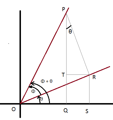

My textbook gives a proof of the relation: sin(θ + Φ) = cosθsinΦ + sinθcosΦ.
It uses a diagram to do so:
http://imgur.com/gLnE2Fn
sin (θ + Φ) = PQ/(OP)
= (PT + RS)/(OP)
= PT/(OP) + RS/(OP)
= PT/(PR) * PR/(OP) + RS/(OR) * OR/(OP)
My confusion with this is
How do they know that angle TPR also measures θ?
How do they know that triangle TPR is similar to triangle ROQ?
Thanks
The textbook is: Calculus with Analytic Geometry, 2e by George F. Simmons

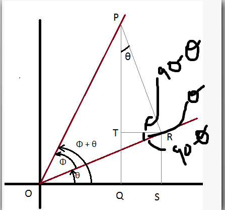

Hey,
I think I kind of figured it out, angle ros = theta, angle ors = 90 -θ
the angle between the TR and the brown line is theta, the angle between PR and the brown line is 90degrees right so angle PRT is 90 - theta and so TPR is theta I've attached a diagram because I feel like these words aren't making sense. Is the diagram clear?
They are similar triangles because they have the same angles.

They use geometry.
I assume they intend for ∠ORP to be a right angle.
∠RTO measures θ. ∠TRP measures 90° - θ . etc.
(I assume you meant ΔROS, not ΔROQ .)
As for ΔTPR and ΔROS, they're both right triangles each having an acute angle with the same measure, namely θ.

thegirl said:
Hey,
Oh, wow thanks. It makes sense now. Thanks especially for taking the time to upload a picture.
