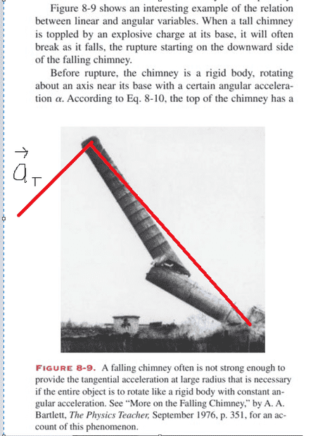

Refer to the two pictures which are from Halliday Resnick Krane Physics 1 about rotational kinematics:
I am confused why the tangential acceleration, $a_T$, is alpha (angular acceleration) times the length of the chimney, L.
My thinking is that it should be the radius of the chimney and not the length of the chimney
a_t = \alpha \cdot r
Pic 1:
Pic 2:
What's the axis of rotation?
Assuming that the chimney is not destroyed yet, the axis of rotation is perpendicular to the ground and goes through the center of the chimney. However, this means that it's multiplied by the radius.
However, since the text mentions the length of the chimney, the author's intended axis of rotation would be parallel to the ground. But I don't see anything rotating with respect to that axis

Hint: The chimney started out vertical. (Presumably. :wink: )
You mean the chimney should be doing something like this?

Oh never mind. I got it. I kinda misunderstood what a chimney is. Here's the picture explaining everything:
Photograph of a tall chimney toppling over, broken partway up, with the upper section falling to the right toward the ground; a red line and hand-drawn arrow labelled a_T are overlaid.
