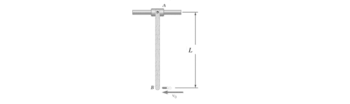

A mass m1 hits a stick (it has mass m2) at its end with velocity v0. After the collision, the stick both slides horizontally with velocity v2' and rotates. Find the angular velocity!
Linear momentum and angular momentum
I am currently reading David Morin book and found this statement :
##\,\,\,\,\,\,\,\,## "It is important to remember that you are free to choose your origin from the legal possibilities of fixed points or the CM"
Is it really alright to choose the center of a rigid body as an origin even though this body is fixed to a point? because when solving the problem above, I found that both methods yield different result.
Here is my attempt
First, we need to calculate its Linear momentum. (This will be useful when we set the fixed point as an origin)
$$m_1\,V_0\,=\,m_2\,V'_2$$
##1.##Now, If I use the center of the stick as the origin, the angular momentum will be like this :
$$m_1\,V_0\frac L 2 \,= \frac {m_2\,L^2\,\omega}{12}$$
$$\frac {6m_1V_0} {m_2\,L} = \omega \,\,\,\,\,\,\,\,\,\,. . . (1)$$
##2.##However, If I am to use the fixed point as the origin :
$$m_1\,V_0\, L \,= \frac {m_2\,L^2\,\omega}{3} + m_2V'_2\frac L 2$$
Substituting the Linear momentum equation into this will yields:
$$m_1\,V_0\, L = \frac {m_2\,L^2\,\omega}{3} + m_1V_0\frac L 2$$
$$m_1\,V_0\frac L 2 = \frac {m_2\,L^2\,\omega}{3} $$
$$\frac {3m_1V_0} {2m_2\,L} = \omega \,\,\,\,\,\,\,\,\,\,. . . (2)$$
As you can see, both methods yield different results. Though, it is really unlikely for the book to make a mistake. So, are there any concepts that I did wrong?

What happens to the mass of the bullet?
The centre of the rod moves in a curved trajectory after the collision - that physical point on the rod is accelerating after the collision. So, you should really take the horizontal axis that runs through the point where the centre of the rod is initially. The motion of the rod relative to this axis is not a simple rotation, so your simple formula does not look right.

I would use the actual pivot point to do the calculation.
If choosing the CM of the stick, I would need to compensate for the reverse movement of the slider towards the right, which would reduce the velocity of A towards the left.
In that case, the amount of momentum that the bullet transferred to linear movement would be reduced, while more of it would be transferred to the rotation of the stick (having less moment of inertia when rotating around its CM than around the pivot, since ##I=(m_1+m_2)L^2##).
Imagine a light stick having a huge moment of inertia hit by same bullet; it would have a resistance to rotation greater than its resistance to slide forward.
Now imagine a heavy stick having a very small moment of inertia; it would quickly rotate about the pivot without sliding much.
The linear momentum of the bullet (m1) before impact is distributed in specific amounts of linear and angular momentum of the system (m1+m2), according to the specific inertia of the mechanism.

Your mistake in method 2 is that you are "double dipping". When you write 1/3 instead of 1/12 you are taking rotation about the endpoint, so that includes the contribution to angular momentum of the linear momentum of the mass centre. And simply dropping the linear contribution doesn't fix it because you don't know the linear speed of the hinged end.
To use the 1/3 form you need to decompose the motion of the stick into a rotation about its endpoint plus a linear motion of that endpoint. If that linear motion is speed u to the left then the actual motion of the mass centre is ##u+\omega L/2## to the left. Equating that to ##V_2'## gives u in terms of the other variables.

@PeroK described the pivot as an inertial frame. It is not. The pivot is mounted on a slider which will undergo a large acceleration during the impact.
You can use the original location of the pivot as the reference point, as @Rikudo did in method 2, but you need to allow for the velocity of the slider. See post #9.

The mass ##m1## has been called a bullet. Is it? Does it imbed into the stick or not? I don't think the problem statement is clear at all and that has to be clear before a solution is reached.

Alright. So, firstly, let us assume that V2' is the translational velocity of the slider (the stick end point). So:
$$m_1\,V_0\, L \,= \frac {m_2\,L^2\,\omega}{3} + m_2(V2' + \omega L)\frac L 2$$
Is this true?

If it does not imbed into the stick then in order to solve the problem correctly we either need to know what its subsequent motion is or have to assume its mass is sufficiently small compared to that of the stick that we can ignore it thereafter.
Let's assume that it is sufficiently small so that we can ignore it after the collision.

This is confusing. We are given v0. Are we given v2' or is it an unknown? This statement seems like v2' is given and we just need to compute ##w##.
bob012345 said:
This is confusing. We are given v0. Are we given v2' or is it an unknown? The statement seems like v2' is given and we just need to compute ##w##.
##V'_2## is unknown
Rikudo said:
##V'_2## is a given value. so, we only need to find the angular velocity
Then that should be straight forward. You know the total angular momentum and that will be conserved. If you pick the right point all the complications should go away.

If we decompose the motion of the stick into a rotation about an endpoint plus a linear velocity then that will be the linear velocity of that endpoint.
I'm going to call the impulse from the bullet p, the slider's velocity u and the stick centre's velocity v.
##mv=p##
##Lp=\frac 13mL^2\omega+\frac L2mu##
(So ##p=\frac 13mL\omega+\frac 12mu##)
##v=u+\frac L2\omega##
Whence ##u=-\frac 13L\omega##. Note the sign. This is the "reverse movement " of the slider, i.e. it moves to the right.
And ##\omega=\frac{6p}{mL}##, as in method 1.
(The m's above should all be ##m_2##)

We need to know what v2 is the velocity of such as the CM, the slider or the end.
Why not ##Lp=\frac 13mL^2\omega+\frac L2mv ## ?(since angular momentum is the summation of ##I \omega## ,and linear momentum of the center of mass times the distance, in this case ##mv \frac L 2##)
