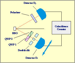

A quick note on the DCQE: If we understand a measurement to be a correlation between a quantum property of the measured system and a classical property of the apparatus, the ambiguity in the DCQE experiment goes away.
A traditional presentation of DCQE might describe detectors ##D_1## and ##D_2## as erasing a previous "which-slit" measurement. But with the above understanding of a measurement, a which-slit measurement only occurs if detectors ##D_3## or ##D_4## are activated. Before this time, no irreversible record exists, and so no measurement has occurred. If a measurement has not occurred, how can it be destroyed by ##D_1## or ##D_2##?
Maybe a better name would be DCQM or "delayed choice quantum measurement".
Take the DCQE as described in
S. P. Walborn, M. O. Terra Cunha, S. Pádua, and C. H. Monken, PRA 65 033818 (2002)
There you have a once and for all fixed measurement protocol, i.e., a data set about the entire ensemble of registered entangled photon pairs. Of course, this data set doesn't change anymore as it should be for a well built experiment.
You "erase" the which-way information by choosing certain subensembles of the photons, which is possible due to the information stored in the measurement protocol, and for that subensembles you get two-slit interference fringes though there are no interference fringes for the total ensemble.
This delayed choice of which ensemble you use is possible due to the preparation of the photon pairs and polarization-entangled pairs via parametric downconversion. Of course this does not imply that you somehow have retrocausal actions into the past or other esoterical ideas sometimes envoked to sell bad popular-science books on QT.
Morbert, in this (Kim et al.) version we indeed have no control if the which-path information will be erased, as it is randomly decided by choosing one of 4 detectors.
But this weakness is overcame in later Walborn's version I have mentioned ( https://journals.aps.org/pra/abstract/10.1103/PhysRevA.65.033818 ), where we directly decide if which-path information should be erased.
Specifically, this information is encoded in polarization of a photon there - this way can be erased or not depending on rotation of polarizer on the way.

This is probably an answer more suited to the interpretations forum but:
If a measurment is the production of an classical record correlated with a measured quantum property, then the measurements in the above experiment occur when ##D_s## and ##D_p## produce classical records, as opposed to when the photons are entangled with a secondary beam. Under this understanding, no which-path measurement is erased.
The paper is perfectly correct. I just think the language can be ambiguous.
