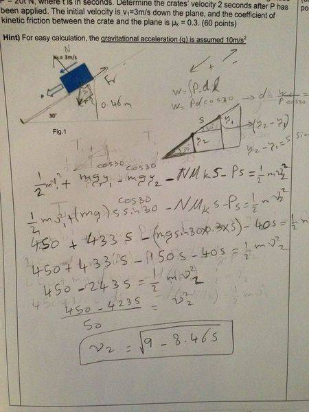

The 100kg crate shown in Fig. 1 is acted upon by a force having a variable magnitude
P = 20t N, where t is in seconds. Determine the crates’ velocity 2 seconds after P has
been applied. The initial velocity is v1=3m/s down the plane, and the coefficient of
kinetic friction between the crate and the plane is μk = 0.3. (60 points)
Hint) For easy calculation, the gravitational acceleration (g) is assumed 10m/s2
T1 + U1-2 = T2
T kinetic energy
U potential Energy
I am having problem finding the distance S ?
Handwritten work on a physics problem: a sketch of a crate on a 30 degree incline with force P and friction, plus energy equations and the derived expression v2 = sqrt(9 - 8.46s).

Think in terms of momentum instead of energy.
Aha ...
mv1 + P t (dlta t) + mg sin 30 (dlta t) - mg cos 30 Mk (dlta t) = mv2
30 + 80 + 1000 + 519.6 = 100 v2
v2 = 5.9 m/s
v2 = 5.9 m/s
Double check the first two terms.
300 + 80 + 1000 - 519.6 = 100 v2
v2 = 8.6 m/s
Shouldn't the friction be negative and what about the P , It is given P = 20 t , shouldn't i multiply it by t=2 twice ??
Yes.
Since the force P is a function of time, you'll need to integrate.
I was wrong about P . P = 20 t → Impulse = ∫ p dt = 20 t2 /2
Thus P = 20 (4) / 2 = 40 N
But isn't the friction impulse negative and thus we get
300 + 40 + 1000 - 519.6 = 100 v2
v2 =8.2 m/s ?

Good!
