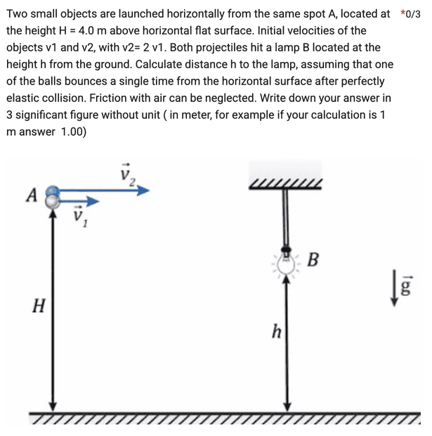

Two small objects are launched horizontally from the same spot A, located at the height H = 4.0 m above horizontal flat surface. Initial velocities of the objects v1 and v2, with v2= 2 v1. Both projectiles hit a lamp B located at the height h from the ground. Calculate distance h to the lamp, assuming that one of the balls bounces a single time from the horizontal surface after perfectly elastic collision. Friction with air can be neglected.

A diagram to help out as well
Okay, it took me a few seconds to figure out what they are asking. I think that the projectile with velocity ##\vec v_2## hits the lamp directly. And, the projecile with velocity ##\vec v_1## hits the lamp after first bouncing on the ground.

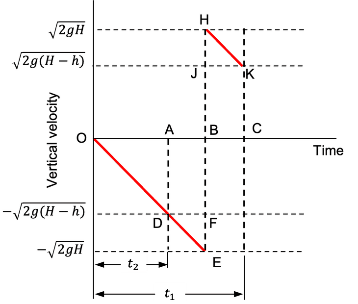

@kuruman's approach in Post #7 has much simpler algebra. You might like to consider the height-time graph for object1:
Edit - cosmetic changes.

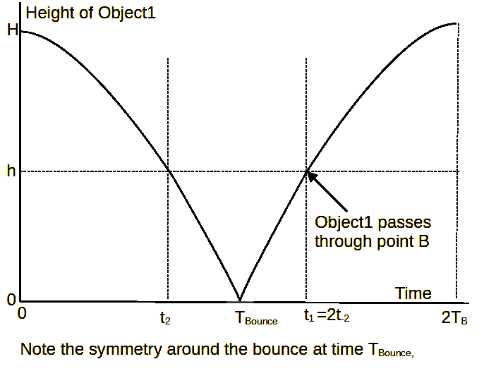

So they reach the same h height point where the bouncing ball reaches it twice, once before and once after.
And, considering their horizontal velocities, one ball reaches it in half the time as opposed to the bouncing one *after* it bounces. But how can I relate this to height?

To summarize, you already got two equations using the notation in post #22
##t_1=2t_2##
##t_1=2T-t_2.##
Here ##T## is the time it takes object 1 to hit the floor and you an easily find it in terms of ##H## and ##g##.
Add to the above an equation that says that in time ##t_2## object 2 drops to a distance ##H-h##.
You now have a system of three equations and three unknowns, ##t_1##, ##t_2## and ##h##. Solve it.
