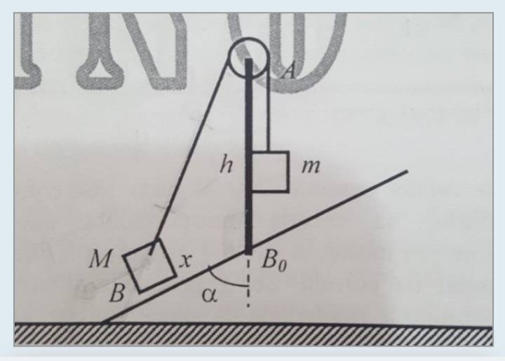

Two material points of masses M and m are joined together by means of a wire that passes in A through a fixed pulley. The mass m hangs vertically; the largest M rests on a smooth inclined plane that forms an [itex]\alpha[/itex] angle with the vertical. M starts its movement, sliding along the plane, without initial speed, starting from point B0 located on the vertical of A. Demonstrate that point M performs amplitude oscillations [itex] x = \overline {B_oB} = \frac {2m (M-m) h \cos \alpha} {m ^ 2-M ^ 2\cos ^ 2 \alpha} [/itex] where [itex]h = \overline {B_oA} [/itex] and fulfilling the condition [itex] M \cos \alpha < m < M [/itex]
Gravitational energy: [itex]mgh[/itex]
If M moves ##x## along the plane, her height variation in ##x \cos(\alpha)##, and, but I don't know how to find the variation of the height of ##m##

If M moves $$x$$ along the plane, her height varation in $$x\cosα[\MATH], and, but I dont't know how to find the variation of the height of $$m$$ :/$$

Consider the change in the length of wire from the mass, M to the pulley, when x = 0, compared to its length for an arbitrary value of x.

Is that bottom plane free to rotate about point ##B_0## like a see-saw? Is that why you can get an oscillatory motion?
No, it's because there is an equilibrium position
given by ##Mg\cos(\alpha)=mg\cos(\alpha-\beta)##
, where beta is the angle of the string to the vertical.
