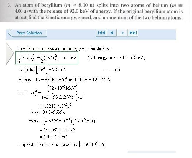

Screenshot of a worked physics solution: energy conservation for two helium atoms, with the equation (1/2)(4u)v1^2 + (1/2)(4u)v2^2 = 92 keV boxed and the final speed 1.49 x 10^6 m/s boxed at the bottom.
I do not understand how in the solution they come up with the first equation that I boxed in with green.
I know that the total energy before is equal to the total energy after but I don't understand the logic of how they formed that first equation. It looks like KE+KE=E to me. What happened to the PE potential energy? And how can the KE of the 2 He atoms be equal to the energy released with the atoms?
I would only think that it would be (PE)Beryllium= 2(KE+PE)Helium+92.0keV
Also, I am two days into the class and my physics teacher has NOT solved a single problem. Has this happened to anyone else?
EDIT: OK, I think I got it? 92.0keV of energy is released which goes into the two He particles and somehow they are traveling at Vmax so there is no PE? That's my guess.
  • Screenshot of a worked physics solution: conservation of energy equation (1/2)(4u)v_f1^2 + (1/2)(4u)v_f2^2 = 92 keV, followed by unit conversions and final speed 1.49 x 10^6 m/s.
OK, I asked my teacher why the PE was not in the equation.
He said something about how the gravitational PE is so small that you can neglect it.
