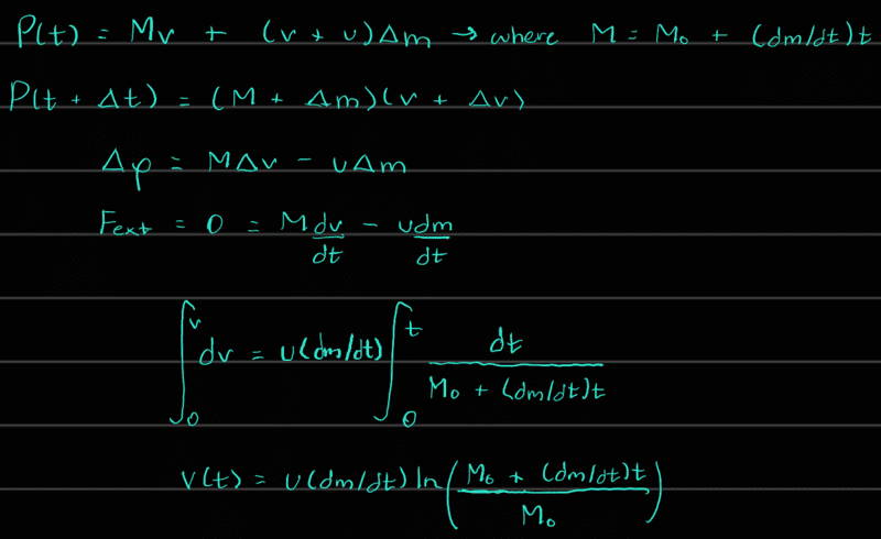

A sand-spraying locomotive sprays sand horizontally into a freight car as shown in the sketch. The locomotive and freight car are not attached. The engineer in the locomotive maintains his speed so that the distance to the freight car is constant. The sand is transferred at a rate dm/dt = 10 kg/s with a velocity 5 m/s relative to the locomotive. The freight car starts from rest with an initial mass of 2000 kg. Find its speed after 100 s.
F_external = 0
If I consider only the freight car's mass and the mass dm that's added to the freight car as part of the system, then I get this answer:
https://ibb.co/QfKSqQ5

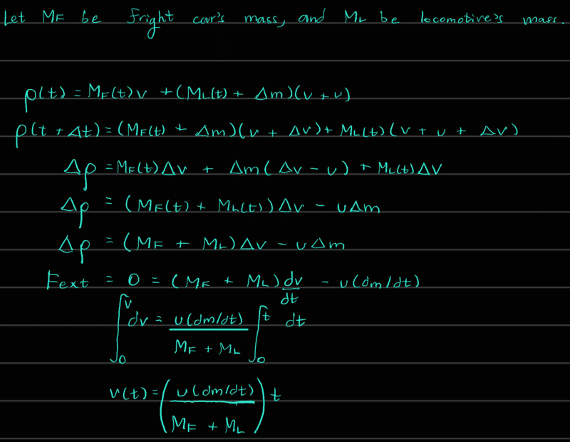

But if I consider the freight car's mass, the mass dm, and the locomotive car as part of the system (maintaining the locomotive has velocity u relative to the freight car), then I get this answer:
https://ibb.co/RNZCbgY
I want to understand why I'm getting 2 different answers in this problem.
The speed of the locomotive is maintained by an unspecified external force, so you cannot include the locomotive's momentum in the conservation equation.

AspiringPhysicist12 said:
Homework Statement:: A sand-spraying locomotive sprays sand horizontally into a freight car as shown in the sketch. The locomotive and freight car are not attached. The engineer in the locomotive maintains his speed so that the distance to the freight car is constant. The sand is transferred at a rate dm/dt = 10 kg/s with a velocity 5 m/s relative to the locomotive. The freight car starts from rest with an initial mass of 2000 kg. Find its speed after 100 s.
Relevant Equations:: F_external = 0
Note that you have an integration error here. You can see the answer is not dimensionally correct.
Thank you, but considering the ground isn't part of the system, isn't there also an external force (i.e. friction) required for the freight car to accelerate? I thought we were neglecting that for simplicity, but if that's not the reason, why would momentum be conserved in the accelerating freight car + dm system?
I think there would have to be friction on the track for the locomotive to accelerate to keep up with the freight car. But the freight car doesn't need friction to accelerate.
That being said, unless they were on different tracks, there would be friction on the track of the freight car... and some non-conservative forces. Maybe this is a bit of a "hand wavy" idealization?
Yeah I'm really confused since they're on the same track. If an external force is required to keep the locomotive moving at speed u relative to the freight train, and if this is why we can't consider it as part of a conserved momentum system, why can we ignore the external force required to accelerate the freight train? They're not attached in the problem either, so it's not like only one of them needs to experience an external force for both to accelerate.
There is no external force required for the freight car to accelerate. It will accelerate on a frictionless track, so long as it is getting an impulse from the sand gun attached to the locomotive. It is just the locomotive that would require friction on the track to keep up with the freight car.
The speed of the locomotive relative to the freight car is 0 in this problem. Just a clarification.

My last question, the acceleration of the freight car comes from the momentum transferred to it by the sprayed sand, right? That's the force causing the freight car to accelerate?
That helps a lot, thank you!
Whether it is an external force depends on your choice of system.
in post #1, your system appears to be the freight car+current load+next instalment of load arriving in time Δt. In that view, the acceleration of the car results from the internal forces that bring those components to the same speed.
If your system is freight car+current load then it is the external force applied by the next instalment of load arriving in time Δt.
Yeah, it's a reaction force from the change in momentum of the sand per unit time ( at least that's how I'm looking at it in this problem ). But as @haruspex pointed out, there may be some subtlety to the interpretation. I don't believe that how you look at it affects the acceleration though, but it may be important for how you write the equations.
The whole point of the problem is that the freight car is being accelerated by the impulse of the sand being pumped into it. It needs no external force to accelerate.
Without an external force the locomotive would recoil and accelerate in the opposite direction. The implication of the problem is that the locomotive uses its engine to prevent this recoil and, moreover, to keep pace with the accelerating freight car.
