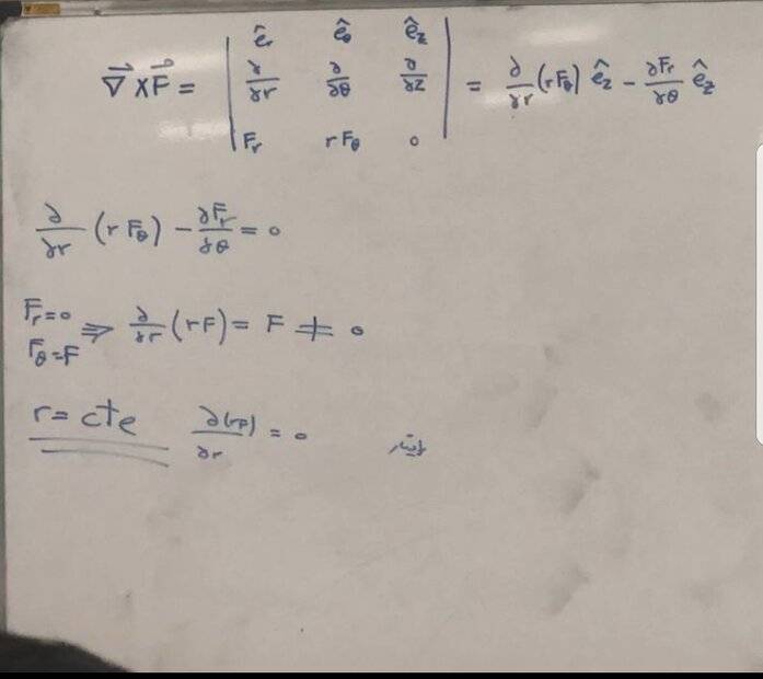

TL;DR Summary: The rigid object move around the circle with constant force how it possible the force
The rigid object move around the circle with constant force how it possible the result of the forces are conservative!?

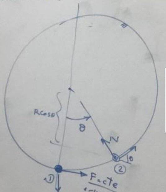

At the first time it's on (1) point in bottom. The F force enter the mass and it's go around the circle.
I know the external force make system non-conservative

disjk47 said:
You have a rigid body moving in a circle. I admit that you never used the word "uniform," but that statement "circular motion" usually implies that it is moving with a constant angular speed. (If this is not the case then the problem statement probably should be changed somewhat to reinforce that this is not uniform motion.) That implies that the magnitude of the force is constant and the force vector changes as the object goes on its path. If that is the case then ##\nabla \times \textbf{F} = 0##, and the force is conservative.
If the force is not constant, but the object is still constrained to move in a circle (say with increasing angular speed), then we may not have a conservative force. We would need more information from the problem statement about the nature of the force.
Are you sure the force vector is constant? If that's the case then the object could be constrained to move along a circular path, ie. the path will not be necessarily be closed, but it will eventually settle down to an equilibrium point. In that case things will be a bit stickier and the force may, indeed, not be conservative. Again, we would have no way to tell from the problem statement. (As mentioned above, gravity would fit this requirement, and gravity is a conservative force. But a rocket pack attached to the object would almost certainly not provide a conservative force and could produce a similar motion.)

Thank you dan for your comments
This is an improvise problem for students and F force isn't gravity or magnetic field, it's a vector force.
Question is work of F force after 1 round trip around the circle.
I know if there's a external force in the system it's conservative force but for curiosity calculate conservative force formula quest what? It's equal 0!
My mind can't handle that why?

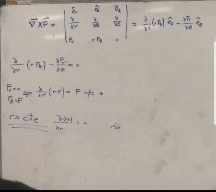

I think you have confused yourself with your work shown in post #7.
First you assume that you have a force field in cylindrical coordinates that is constrained in the xy-plane and set ##F_z=0.## That's OK.
Then you take the curl using an incorrect expression. The correct expression is $$
\vec{\nabla}\times\vec F=
\begin{vmatrix}
\dfrac{1}{\rho}~\hat{\rho} & \hat{\phi} & \dfrac{1}{\rho}~\hat{z} \\
\dfrac{\partial}{\partial \rho} & \dfrac{\partial}{\partial \phi} & \dfrac{\partial}{\partial z} \\
F_{\rho} & \rho~F_{\phi} & 0
\end{vmatrix} $$Note the difference in the top row with what you have. However, that is not the problem because fortuitously you get the appropriate expression for the z-component of the curl for ##\rho \neq 0 ## $$\frac{\partial}{\partial \rho}(\rho~F_{\phi})-\frac{\partial F_{\rho}}{\partial \phi}=0.
$$Then you set ##F_{\rho}=0.## That's not OK. You cannot have an object follow a curved path if the radial component of the force acting on it is zero. A ball tied to the end of a string will go around in a circle as long as the string is there. If you cut the string and set the radial force equal to zero, the ball will move in a straight line.
