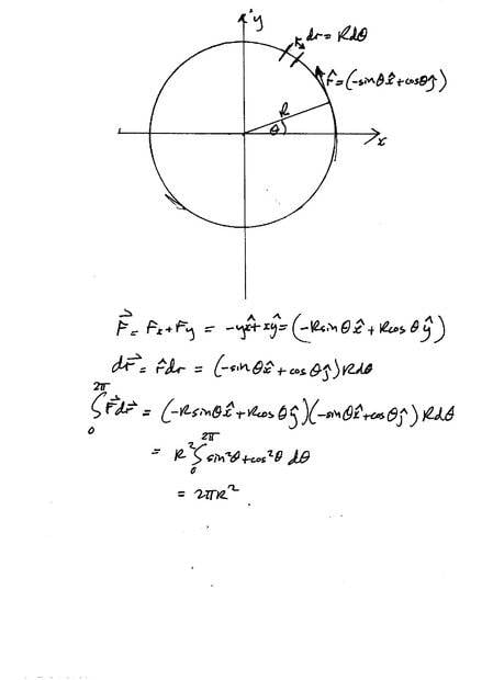

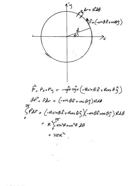

OK, I'll think about that. I think I've gotten way confused here because I had something like the following sketch in mind (which is obviously wrong, but I include it merely to elucidate my state of confusion):
To write ##\hat r=\hat r_x+\hat r_y##, those last two terms must mean "the x component of the unit vector ##\hat r##", etc. So that should turn into ##\cos(\theta)\hat x+\sin(\theta)\hat y##. What you have written would have magnitude r instead of magnitude 1 and is at a right angle to ##\vec r##.

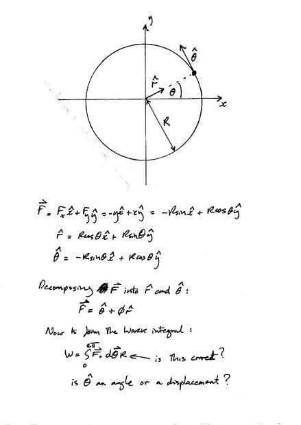

I drew it out using @PeroK's nomenclature. I still have questions:
I previously read your ##F_x## etc. as ##\hat r_x##, etc. Please try to use LaTeX.
The second line is wrong. ##\hat r=\cos(\theta)\hat x+\sin(\theta)\hat y##; ##\vec r=r\hat r=r\cos(\theta)\hat x+r\sin(\theta)\hat y##.
##\hat\theta## is neither an angle nor a displacement. It is the unit vector in the anticlockwise tangential direction.

Ah that was careless. I did not mean to write that.
Yes I understand the unit vectors now.
Decomposing, this means that ##\vec F = R \hat \theta + 0 \hat r##.
And now to form the work integral. I imagine it's the integral over ##d\theta## of ##\vec F## dotted with something? Perhaps it's:$$\int_0^{2\pi} \vec F \cdot R \hat \theta \, d \theta$$
I'd appreciate completing this!
EDIT:
Well, I'll carry on with it assuming:$$W = \int_0^{2\pi} \vec F \cdot R \hat \theta \, d \theta$$
$$= R^2 \int_0^{2\pi} \, d \theta$$
$$= 2 \pi R^2$$
