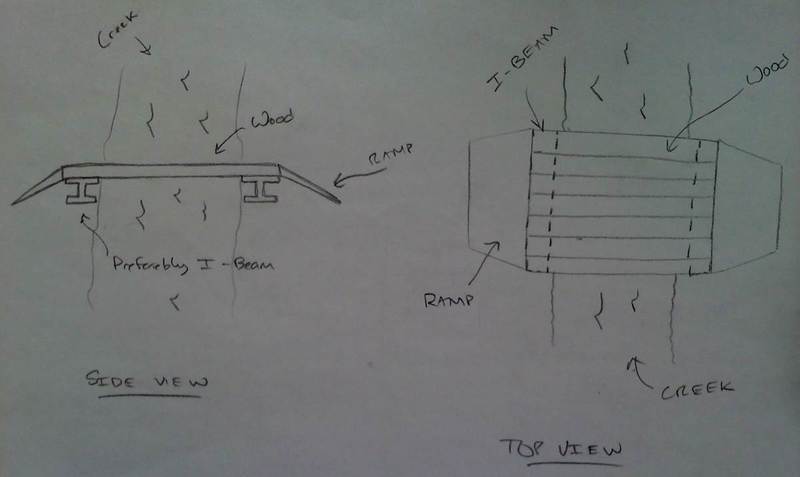

Hello all,
I am currently trying to figure out a cheap way to build a "bridge" that will go in my back yard. It will primarily be used to drive my 2000lb lawn mower over a small creek. I want to support it with 2 to beams at a 30 ft span as I will rest 2x8 or 2X10 pieces of wood on it. It will be flat and just have a small incline on each side to get on and off it. I need to figure out what beam size to use (preferably I-beam). Any formulas or any advice that applies to my situation helps a lot. Thank you in advance. I have also attached a sketch so you can visualize what I am discussing.

The way you've drawn the picture, it appears you are thinking of having the 2x boards span the 30 foot gap across the stream. Laying 2x boards flat, spanning from I-beam to I-beam will not provide a useful beam/bridge. 2x boards laid flat will not support much of a load.
Consider making the bridge with 2 beams spanning the stream, with 2x boards spanning between the beams to form the roadway. The beams might be fabricated from 2x boards on edge, with several laminated together to form strong beams. Those beams would then rest on footers on each side of the stream. The footers could be the I-beams, or more economically they could be concrete blocks, setting on a pad to distribute the loading into the ground. You would not need to have the blocks run from beam to beam.
I've not run numbers for these beams, but think of each beam being formed by laminating 4 2x10's. You would need to splice about 3 2x10 to get the length. The splice joints could be made by butting them end to end and sandwiching/tying them to the adjacent boards with long screws or bolts. Splice joints would need to be staggered such they are some distance apart.
The roadway could then be laid either on top of the beams, or set on a ledger board fastened to the side of the beams. If the bridge is fairly narrow (4 ft?) you may be able to just use a single layer of 2x. However, I suspect you will need to at least double them up, and tie (screw) the layers together. Or you might consider fastening a 2x4 to the underside of each roadway piece to form a 'T' beam.

Oh, my, I just read DickL's message and made me look at the picture...
I just noticed that my description of the problem does not correspond to the way you have drawn the bridge...instead, I went under the assumption that you were going to use the I-beams to span the width of the stream...just like DickL suggests...that's the way to go.
So, please read my post previous post with that in mind and it should make much more sense.
So, think of your bridge like an upside down railroad track...instead of the I-beams on top of the sleepers, you want to put 2 I-beams that span the stream (one end of the I-beam is on one side of the stream and the other one on the other side) and on top of the I-beams you want to put sleepers across so that you can drive over them...

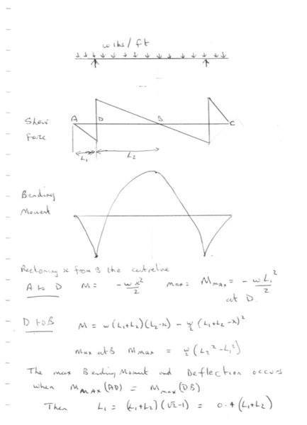

For maximum stength your I beams should be placed at the one third points of the cross span, not at the edges.

Studiot said:
For maximum strength, your I-beams should be placed at the one-third points of the cross span.
That appears to be incorrect. For maximum strength, the I-beams probably would be placed at the one-sixth points of the joists (or deck beams), measured from the joist ends. (However, it might depend on the vehicle wheel base.)
Hello, nvn I suppose it depends upon the way you usually look at these things.
I normally consider the half section for symmetrical loading.
Anyway an overhang of one third of the half or one sixth overall is not quite theoretically perfect but quite close.
Since the vehicle is likely to have wide tyres and or rollers I have modeled a distributed load for the cross section.
You can see the theoretical best place for a simple support is 0.414 times the hald width in from the end.

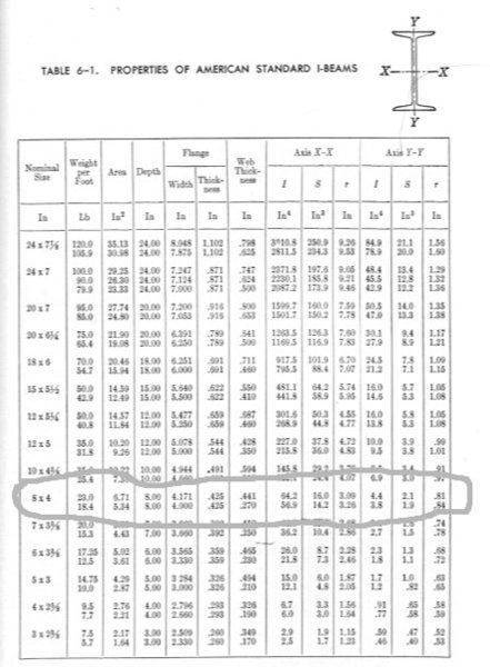

I do not have many american standard tables but what I have suggests that a
20 x 7 x 95lbs/ft beam would just suffice (S=14) since I have deliberately overestimated for the trial.
A 24 x 7.875 x 105.9 lbs per ft would be safer at S=20

Studiot: If you get a chance, would you be able to state the I-beam size listed in post 11 as a Euronorm standard HE size, so we may know what size you are referring to?
I was rather rushing last night and looked in the wrong column.
When I look in the correct one I see that a much smaller I beam will suffice
An 8 x 4 x 23lb/ft looks better.
This reduces the beam weight to 700 lbs
Thus the max moment is now 166500
and the required section modulus greater than 8.3
The 8 x 4 has a section modulus of 16 (correct this time).

Studiot: It appears you are referring to an imperial I-beam called S8 x 23. Your maximum moment is slightly incorrect. You might want to check your numbers.
More importantly, your I-beam is overstressed. The laterally-unbraced length is 9.14 m; but it appears you ignored lateral-torsional buckling, which is a leading cause of steel structure failures.
The I-beam would instead need to be, at least, a European standard HE 200 AA, or an HE 180 A, or an imperial W8 x 24.
Yes you are right its 193500, making the required modulus 9.675.
The American 8 x 4 I section will easily accommodate this.
