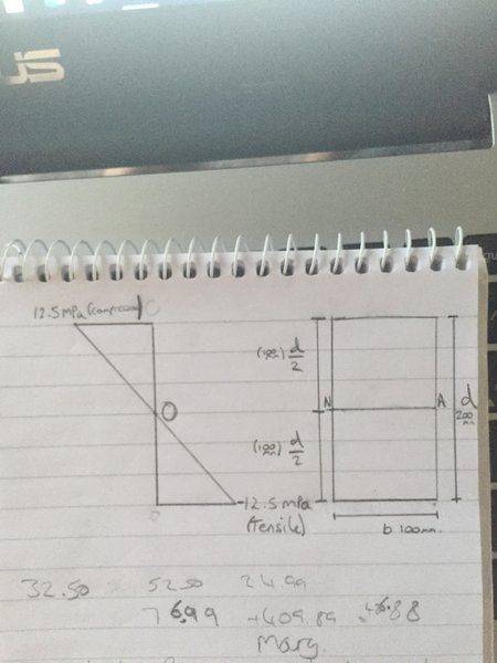

c) I have to admit i don't really know what diagram this is referring too and have no idea of what to draw nor figures to use.

no problem, let me know when you have sketched something. It should look like something in this lower left quadrant of this picture .

Okay so below is my picture. After we’ve gone through c) can I just get a double confirm everything is good :) thanks again!

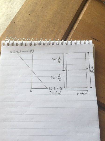

You have the correct shape.
Tensile force should be -12.5 MPa ( just make sure compressive and tensile forces are of different signs, follow consistent sign convention)
At the N.A , stress is 0 ( you said a stress of 0 is at the same location of the maximum tensile force). So when your line crosses the N.A, at d/2 = 100 mm , stress is 0.
So, you should have the values : 12.5 , 0 , -12.5 in this order from top to bottom ( for the triangle you drew)

So more like this picture? I’ve placed the 0 next to the neutral axis (just to show it’s at that point), and added a negative sign to the tensile stress. Does this now satisfy the question 2c)? If so is everything overall looking like a correct solution to the whole question?
Ignore the information below the diagram that was some insurance quote figures! Haha

Yea, it looks good !
