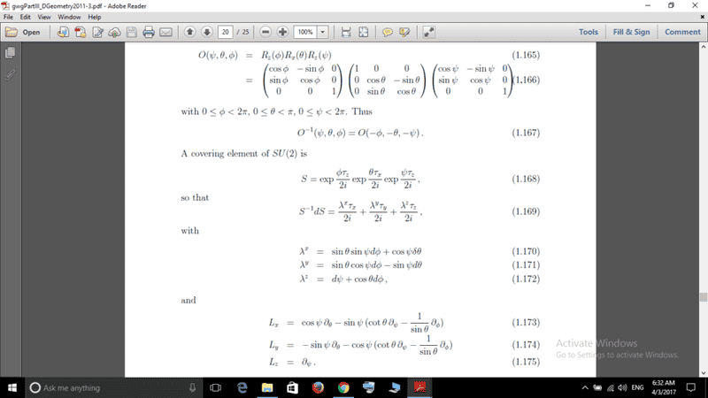

hello every one
can one please construct for me left invariant vector field of so(3) rotational algebra using Euler angles ( coordinates ) by using the push-forward of left invariant vector field ? iv'e been searching for a method for over a month , but i did not find any well defined method for my case . i uploaded a pdf the give a direct formula for left invariant vector field , I've been trying to use push-forward method for one parameter subgroup , but i failed
  • 3-2-1-Eulerangles.pdf

i know this method but it's not working very well , there is a clear method by Dr. frederic P. sculler, using push-forward of left invariant vector field in a chart , but the issue is that i can not project the matrix of ( SO(3) group ) in a proper way on a chart . can i do this method for a one parameter subgroup like SO(3) ?

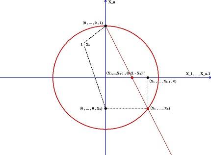

For an atlas you should use the two stereographic projections from the north, resp. the south poles onto the equatorial plane.
