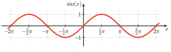

And you get constructive interference when the path length difference is a multiple of 2π, not just π. You can see that by looking at the plot of a sinusoidal waveform. See how the wave repeats itself every 2π? If you add two waves that are π apart in phase, they cancel each other out. Can you see that now? :smile:
ADD -- Sorry, I mistread your post. You did say when the PD is a multiple of the wavelength, not of π.
https://betterexplained.com/wp-content/uploads/sine/sine-plot.gif
EDIT -- Merlin types faster than I do! :smile:
