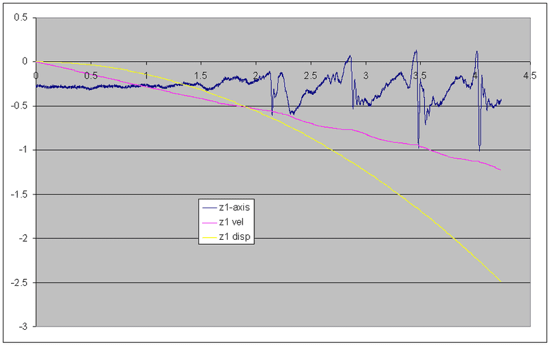

I did some acceleration collection on a person walking 20 meters down a hall and in the graph attachement the displacement and velocities looks weird. I sampled the acceleration data 2khz and it's in G-forces. the person is walking about 1-2 hz. Does this calc work for my acceleration data values?
Thanks!

Wow, you really: do not want to use the formulas mentioned in this thread. Integrations of accelerations are susceptible to drift and notoriously horrible because you are integrating noise.
There is away to do this by fusing the sensor data with periodic measurements from other sources. I forgot the name of this thing...I'll post it when I remember.
Double integration of raw acceleration data is a pretty poor estimate for displacement. The reason is that at each integration, you are compounding the noise in the data.
If you are dead set on working in the time-domain, the best results come from the following steps.

If you change the accelleration into a 3 equation parametric form (x, y, z), and integrate it twice, you should end up with the total displacement of the wrist in each of the three dimensions. From here, it becomes a distance formula problem. I.e., Displacement = sqrt(deltax^2 + deltay^2 + deltaz^2).
You will have to pardon my poor setup. I'm still new to the forum, and don't know how to express the symbols properly - so I used GameMaker 8 code format. :P
I don't think you understand my question completely. Even if I do what you said how will the component of gravity separate from the calculation? I tried integrating to get the velocity but the values were inaccurate as the g ( acc due to gravity) played a role in the value if you know what I mean?
