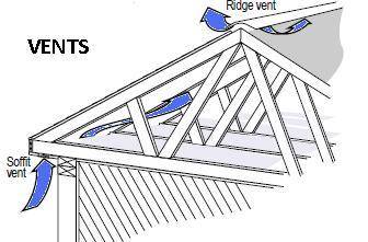

Anyway, the issue here is not to try to actively cool the attic but to let it cool itself. I'll bet dollars to donuts you do not have ventilated soffits in your eaves. What you want is an airflow that enters underneath your eaves troughs and flows up the inside of the peaked roof in your attic, and out the top. Without it, all the fans in the world will do you little good.
This is the problem with my attic. It too gets hot as blazes, and the reason is because when the attic was finished they did not allow enough soffit ventilation.

So you need some openings down low and others up high so as to create natural flow of air. warm air rises and as it does will pull in cooler outside air from below. And of course you should insulate the ceiling in the attic...There are standards for setting such ventilation areas.
Like Dave, I had to add soffit ventilation area as well as additional high roof vents. My problem was that on cold winter days when the sun would rise I had condensation on the underside of my roof.

i actually have enough soffit ventilation given the 1/150 rule, which is better than the 1/300 rule for attic ventilation. I also have two 1500cfm fans that run during the day.
