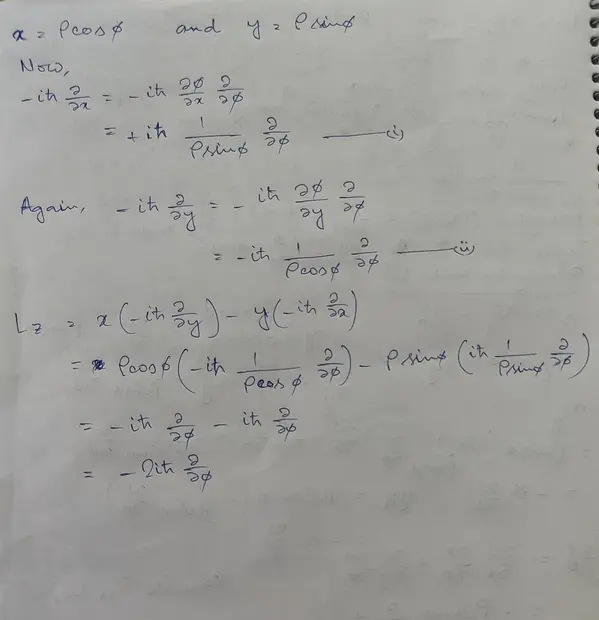

I need to convert z component of angular momentum operator (in quantum mechanics) Lz from cartesian to polar coordinates
L_z = -i \hbar \frac{\partial}{\partial \phi}
I have done this:
Handwritten derivation converting the angular momentum operator L_z to polar coordinates, using x = ρ cos φ and y = ρ sin φ, with partial derivatives with respect to x and y rewritten via the chain rule, ending in L_z = -iħ ∂/∂φ.
I can't clearly understand where I went wrong. Any help would be greatly appreciated. Thanks in advance.
I would start from [tex]\begin{split}<br /> \frac{\partial}{\partial \rho} &= \frac{\partial x}{\partial \rho}\frac{\partial}{\partial x} + \frac{\partial y}{\partial \rho}\frac{\partial}{\partial y} \\<br /> &= \cos \phi \frac{\partial }{\partial x} + \sin \phi \frac{\partial}{\partial y} \\<br /> \frac{\partial}{\partial \phi} &= \frac{\partial x}{\partial \phi}\frac{\partial}{\partial x} + \frac{\partial y}{\partial \phi}\frac{\partial}{\partial y} \\<br /> &= -\rho \sin \phi \frac{\partial}{\partial x} + \rho \cos \phi \frac{\partial}{\partial y}<br /> \end{split}[/tex] and solve for [itex]\frac{\partial}{\partial \phi}[/itex] in terms of [itex]\frac{\partial}{\partial x}[/itex] and [itex]\frac{\partial}{\partial y}[/itex].

Thanks for help. But I wanted to know where I went wrong. Seems like (I) and (ii) is wrong. But I can't understand why.

A partial derivative with respect to rho must also be included into equations.
