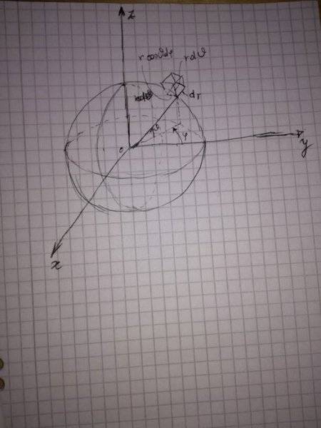

Dear "General Math" Community,
my goal is to calculate the following integral $$\mathcal{I} = \int_{-\infty }^{+\infty }\frac{f\left ( \mathbf{\vec{x}} \right )}{\left | \mathbf{\vec{c}}- \mathbf{\vec{x}} \right |}d^{3}x $$ in the particular case in which [itex] f\left ( \mathbf{\vec{x}} \right )=f\left ( x \right ) [/itex] where [itex] x=\left | \mathbf{\vec{x}} \right | [/itex].
I switched to spherical coordinates and wrote [itex]\left | \mathbf{\vec{c}- \mathbf{\vec{x}}} \right |= \sqrt{c^{2}+x^{2}-2cx\cos \vartheta }[/itex] and [itex]d^{3}x=x^{2}\cos \vartheta d\varphi d\vartheta dx[/itex]. After the integration in [itex]\varphi[/itex] and [itex]\vartheta[/itex] it just remains $$\mathcal{I} = \frac{1}{c}\int_{0}^{c}fx^{2}dx+\int_{c}^{+\infty }fxdx.$$
The integral can also be seen as the convoultion of the function [itex]f[/itex] with the function [itex]\frac{1}{\left | \mathbf{\vec{x}} \right |}[/itex] so I expect to find the same result if I evaluate $$\mathscr{F}^{-1}\left \{ \hat{f} \cdot \frac{1}{k^{2}}\right \}$$ where [itex]\hat{f}[/itex] and [itex]\frac{1}{k^{2}}[/itex] are the Fourier transforms of the function [itex]f[/itex] and the Coulomb potential up to some coefficients respectively.
So now I can write $$\int_{0}^{2\pi }\int_{-\frac{\pi }{2}}^{\frac{\pi}{2}}\int_{0}^{\infty }\frac{\hat{f}}{k^{2}}k^{2}e^{i\vec{\mathbf{k}}\cdot \vec{\mathbf{x}}}\cos \vartheta d\vartheta dkd\varphi = 2\pi\int_{-\frac{\pi }{2}}^{\frac{\pi}{2}}\int_{0}^{\infty }\frac{\hat{f}}{k^{2}}k^{2}e^{ikx\sin \vartheta } \cos \vartheta d\vartheta dk=$$$$=2\pi \int_{0}^{\infty }\hat{f}dk\int_{-\frac{\pi }{2}}^{\frac{\pi }{2}}e^{ikx\sin \vartheta } \cos \vartheta d\vartheta.$$
Performing the integration in [itex]\vartheta[/itex] yelds [itex]\frac{1}{kx}\sin \left ( kx \right )[/itex] which finally brings to $$\frac{1}{x}\int_{0}^{\infty }\frac{f}{k}\sin \left ( kw \right )dk.$$
I am stuck at this point and I do not see how to recover the first solution.
Can anybody help me out?
Thank you very much in advance

kaniello said:
I switched to spherical coordinates and wrote $$|\vec c− \vec x|=\sqrt{c^2+x^2−2cx\cos\theta }\ \ \ \rm { and } \ \ d^3 x= x^2\sin\theta \;d\phi \; d\theta \;dx$$
But these ##\theta## are not one and the same !
(##d^3 x## has a ##\sin\theta##!)
(Anyone know why ##\TeX## comes with a different font for the x in the d3x above ?)
answer: my mistake. I did \rm {and} instead of {\rm and} :rolleyes:
In general you're correct. But you can choose your z axis to be parallel with ## \vec c ## or ## \vec x ##. Then the angle between them is the same as the ## \theta ## of the spherical coordinates.

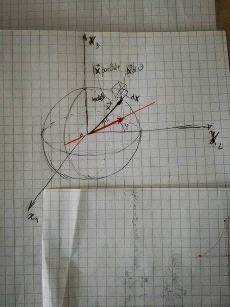

I did my best to draw it [emoji6]
I see, now what about vector ##\vec c##? Since it's fixed in the integration, you need to pick certain direction for it. To which direction did you align ##\vec c##?

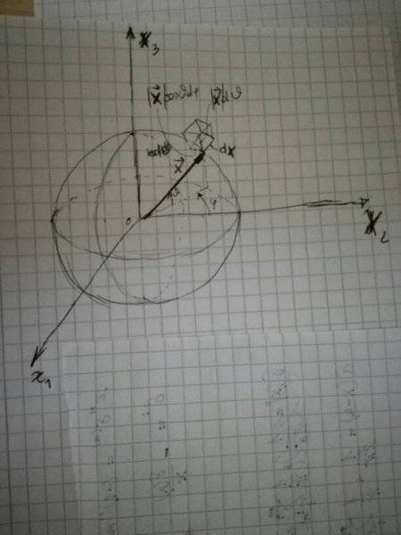

##? Please describe in terms of angle subtended by which vectors.
This is maybe more clear
Yes I understand what ##\theta## is, it's the angle between ##\vec x## and its projection in the ##(x_1,x_2)## plane. But we also need to know where ##\vec c## is in your diagram.
What if pick the red line?
You can but that's not a wise choice. If you do that, the expression for ##|\vec c - \vec x|## will get very messy, for instance the angle between ##\vec x## and ##\vec c## is not always ##\theta## as you defined in the picture. Only for ##\vec x## that lies in the same plane as ##\vec c## and ##x_3## axis can be described by your ##\theta##. I suggest that you pick ##x_3## to align your vector ##\vec c##.
My intention was in fact to place the red lines in the plane ##x_1 x_2## so that it forms the angle ##\theta## with ##\vec x##. As you suggested ##\vec x## should be in the plane ##\vec c## x_3## axis.
No, since you integrate over the entire space, ##\vec x## can have arbitrary direction. There is actually no difficulty in changing ##\vec c## to ##x_3## axis while expressing ##|\vec c -\vec x|## in terms of ##\theta##. You just need to use sine instead of cosine which was the reason I asked in post #4.
