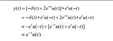

How were they able to simplify the following?
I understand the distributive property and how the convolution component of the delta dirac function worked but I do not understand how the second term convoluted becomes what it is.
Thank you for your time
If I'm missing pre-requisite knowledge where would I got acquire this?
All you need is to use the definition of convolution. You should find that the limits of integration depend on whether t>0 or t<0.
